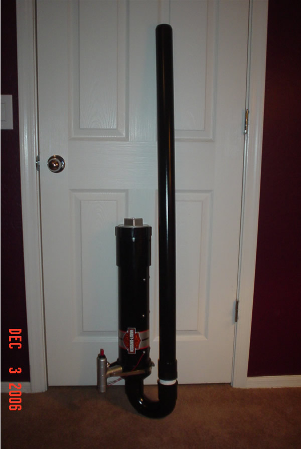

This spudgun was actually built as a gift for my uncle who has been riding for years. He's way into Harleys and I thought a spudgun themed that way would be pretty cool. It'll make a perfect Christmas present. The combustion chamber is 18" x 4" with dual ignition points all internally wired with solid 14 ga copper, including the ignition points. The barrel is 48" x 2" with a knife edge. Hope ya'll like it.

Ohhh it's so cool! I wanna touch it :D very clean job. Make a mclaren f1 themed gun next, Or maybe a ferrari?

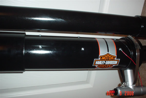

Here's a close-up of the chamber. You can see the ignition screws better in this pic.

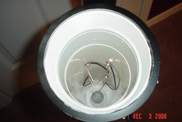

Looking down the chamber is the dual ignition and all of the wiring for it. I like puting the wires on the inside, it keeps the look clean and the combistion doesn't really last long enough to damage the wiring. I've been using the solid copper wiring for a while now. After a few uses the ignition points tarnish but there hasn't been any performance degradation so I'll keep doing it that way.

nice gun, im not a big fan of harleys but its awsome anyway. the only thing i wouldn't do is put the copper ignition... um spikes at an angle i'd put them in across from eachother in a straight line
