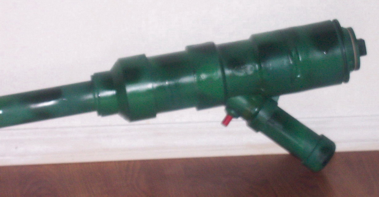

Here is my first spud gun.
It is made of 3 inch abs reduced down to 1.5 abs.
I see alot of pvc spud guns but trust me I work with abs and pvc everyday.I yet have seen abs break.If you do use pvc make sure its shedule 80 as shed 40 is too brittle.[/img]

Can anyone else see the picture????? I can't :cry:
Is it the way he uploaded the pic or is it just my pc????

Try this again , if it doesnt work I have added it to the album

negative.

hehehe I see it now. Looks good, but are they DWV fittings?? Take some more pics, I love the paintjob

Nice gun, I like the paintjob.
Sch 40 PVC is fine, Sch 80 is too expensive and hard to get.

The are dwv fittings what I have done though is used 3" couplings and glued them togerther at the combustion chamber,that way everything is double walled making it stronger. on the back i used a 3by 2 reducer and a 2"fitting clean out.Lose less propane filling and easier to use than a 3 in ch.The handle on the 3 by 1.5 has been filled to stop any combustion from entering it protecting the trigger.
As for pvc I use it when plumbing ground services and when i just moving pipe around It tends to break. Abs I can through around the job site with no worries.
Shed 80 is exspensive but is found at most irrigation shops.
Will add more pics soon.

Sorry for the mistake it is solid wall abs!Not cell core.

nice first gun beter than mine was
