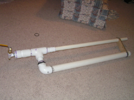

The whole gun assembled.

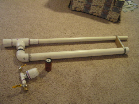

The whole gun disassembled.

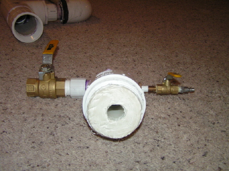

Picture of the fill/exhause/bumper.  The fill is a 1/4" ball valve and quick connect, the exhaust is a 1" ball valve, and the bumper is a thick layer of caulk.

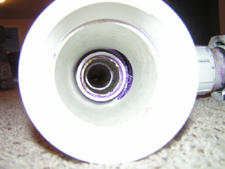

Here's a picture of the inside of the tee.  You can see the coupler that I glued on to keep it nice and square.  It also helps increase the pressure differential once the piston starts moving.  Also, you can kindof see the pipe that I sleeved inside of the tee.

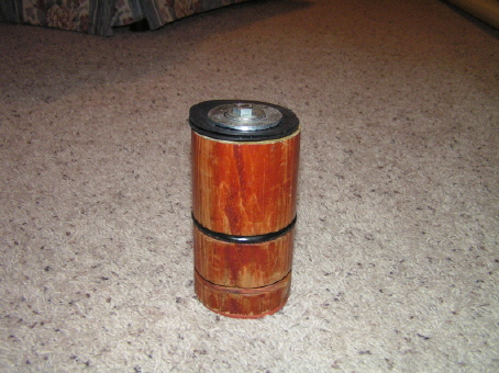

Here's the pison.  I know it only has one o-ring on it right now but I haven't been able to get ahold of some new ones.  Therefor it will be o-ringless until I get some(except for this picture)

Nice job! Especially on the piston. It looks great for your first one.
squeaks
Posts: 326
Joined: Sun Oct 01, 2006 5:45 pm
Location: Enoch, UT(next to Cedar City)
Funny story behind that piston. We got my physics teacher to turn a 4x4 down on a lathe, then we made one o-ring groove with a table saw at my neighbors house, got tired of making 'em that way(and ruining 2 previous pistons made of pvc) and made the second groove on the lathe. Ironically the table saw groove is the better of the two.

Looks good. Is the wood holding up well?
squeaks
Posts: 326
Wood holds up great. Plus the caulk pad takes most of the impact.
