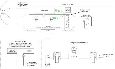

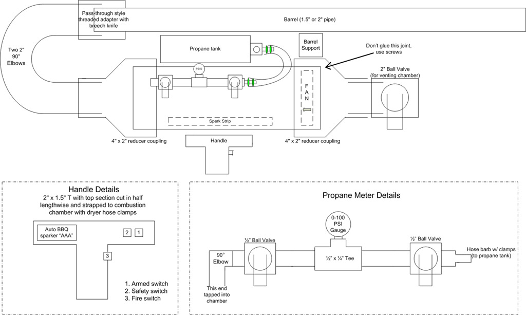

Attached is a quick drawing of the design I'm working on now. You could add a second meter pipe for oxygen and attach both meters with a T. Also attached is a set of Excel spreadsheets called the ProMeter Suite (in a zip file, I promise it's virus free). The sheet called ProMeterOX gives you proper propane and oxygen meter pipe sizes for a given chamber size. Hope these are helpful to you.
Good luck. Let me know if there's any other questions I can answer.
