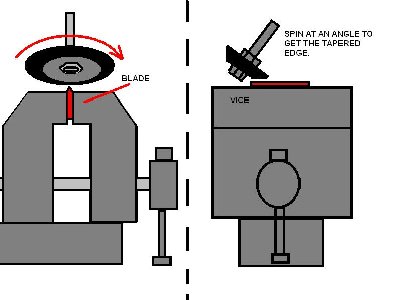

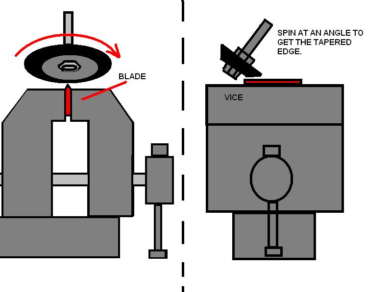

First, cut a thick neoprene sheet into a circle slightly larger than the piston housing.Put a threaded rod through the middle and clamp it in with some nuts.
Put the rod in a basic electric drill.
You now have half a lathe.
Put the blade in the vice , with only about 2 mm of the edge sticking out.
THis will be your cutter.
Spin the drill at maximum velocity and gentley ( sp?) start grinding the neoprene circle straight on top of the blade,pushing it onto the vice. BUT WITH THE DISC AT AN ANGLE!!
This way the sheet of neopren becomes tapered.
You will need to practice this and learn to hold the spinning drill in just the right spot to avoid the whole thing starting to bounce.It should feel smooth if you do it careful enough.
This way you can shape the sheet anyway you like.
The idea is to end up with a smooth tapered shape.Finish it off by spinning it perfectly smooth on fine sandpaper.
You do the same thing with a slightly smaller diameter neoprene disc to fit INSIDE the barrel.
It MUST however still be slightly oversized.

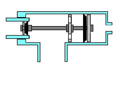

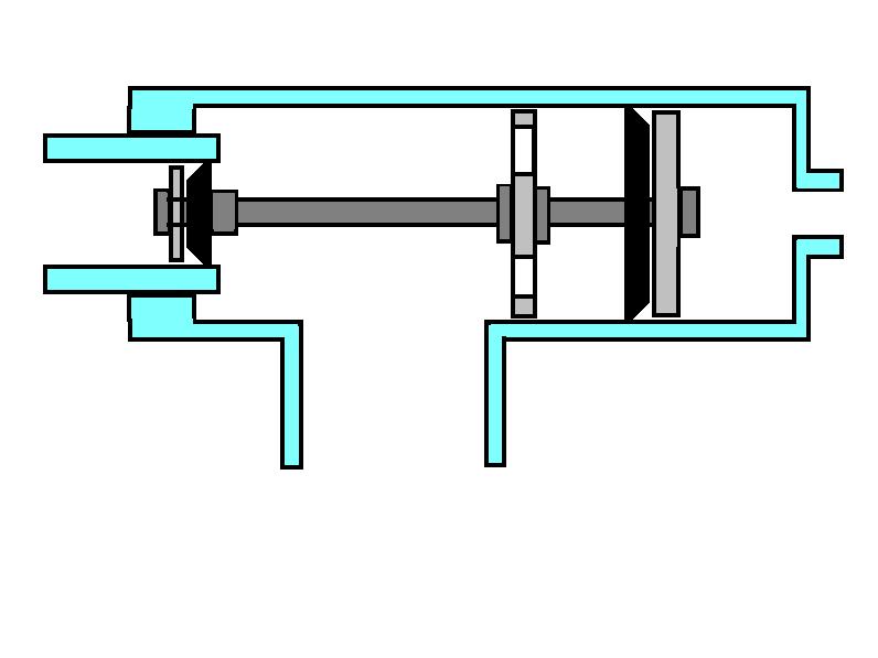

With these two rubber discs you can now make a piston wich seals perfectly INSIDE the barrel, and wich will allow filling from the backside, but will not allow any backflow.This will cause a very powerfull pop when discharged.The front "barrelphram" can NOT be used without the back one.Without the back the front can NOT be pulled out the barrel because of the pressure on the front causing friction.
Feel free to build your own, just don't forget who came up with it!
Below is an example.I forgot to add a stopper in the pic to stop the piston from going into the barrel too far, but those of you who think this idea through will get what I mean, and see the potential.
I showed the middle washer with big holes in it, so effectively the chamber gets bigger.
The upper pic should explain how to spin the phrams into shape.
100% seal, no O-rings!

The discs should be slightly larger than I showed in the pic.I just showed it like this to show off the tapered edge.
When the discs are bigger they bulge and seal off the pipe completely.
They can't flip over to let the air out because of the metal washers.They are pressed into place, sealing the edges.
I have tried it, it works like a charm.

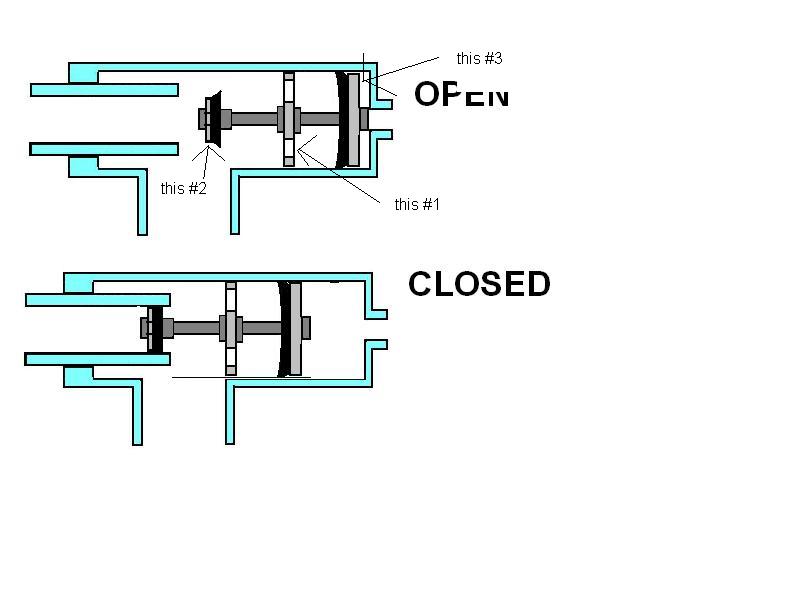

thats pretty nice, the diffrent sized diaphrams in the valve confuse me, but Ive seen some sanding disks that might work
- Brian the brain
- Posts: 3497
- Location: Holland
- Been thanked: 7 times
What??? Sanding discs don't seal.
The different size has to do with the workings of a piston valve

I still dont get the tee valve, is the chamber opening from the bottom, if so how could air dumping behind the smaller disk be enough to pull the larger disk since it has more surface area where presure is aplicated to make it move left,
I'm just a little confused
- Brian the brain
- Posts: 3497
- Location: Holland
Yes you are!
Very confused!!
And to think you are so close!!
If a small surface can not pull away the larger one.....would it be possible
the larger surface is supposed to pull away the smaller one???
DUH!!
Sorry to ridicule you..it's all in good humor.
The bottom is the inlet from the reservoir, the left side is where the barrel is, the pilot area ( wich empties through a valve) is depicted on the right.
Very confused!!
DUH!!
- Just threw this together, so nothing is to scale.The way I drew this the valve would have too little flow, So in reality, the piston should have more travel.
- opened-closed phram.JPG (28.24 KiB) Viewed 12551 times

oooohh
whoops
