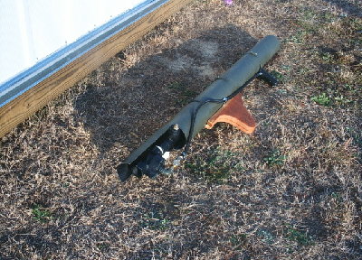

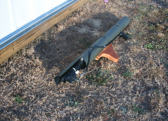

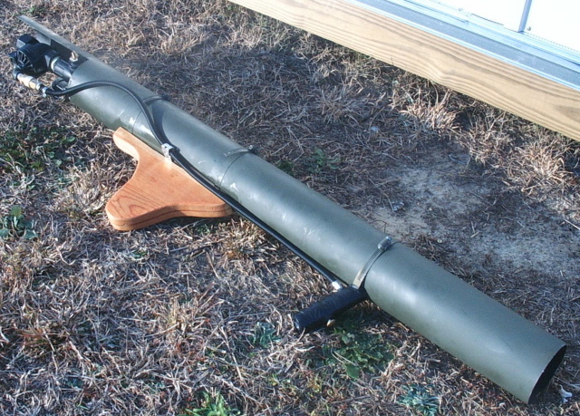

Well I’ve made reference to this gun before as my “LAW” or my coaxial air cannon; I figured I might as well post it.
It was never finished, meeting an untimely demise at the hands of gravity (it fell of the loading bench well I was doing some test fires last week.), but here are some of the original pictures and the guns specs:
Caliber: 1.50 inch
Barrel length: 28 inches
Camber diameter: 3 inches
Chamber length: 28 inches
Muzzle velocity with a 3oz. projectile: approx. 300FPS
Max arming range: approx. 300 yards
Max combat range: approx. 150 yards
Accurate range: approx. 100yards
Min arming range: approx. 30 yards
The piston was made out of hot glue, works great, and the sealing face is sheet rubber labeled as “gasket material”.
The muzzle end has a built in coupler and the plan was to modify that and a short piece of pipe so that the barrel could easily be extended for longer ranges.
Originally it had a 0-100psi gauge on it but I upgraded it to a 0-150psi gauge.
Later on I added a ball valve safety, and some decals.
When I get around to fixing it I’ll paint on the decals and put a brass plate on the butt-stock with the make and model on it.

Very nice cannon. So you sleeved the 3" chamber in 4" pipe?
