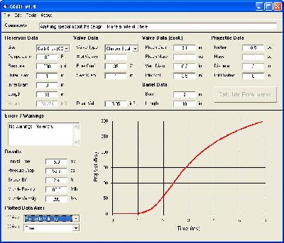

Im working on designing an M79 and need some advice/recomendations.
I want it to look like an M79....not an M14 like the ones online.
I want to shoot nerf footballs....the 2 inch kind.
I have it worked out on GGDT and I need to fit 50 cu inches into the gun somewhere. Any ideas.
Ill get 200 fps with 50 cu in and a 10 in barrell.
That leaves 4 inches of barrell space to put the valve. I need some place to put the chamber...I was thinking in the stock...but there pretty thin so not much room

My advice is to keep the chamber as small as possible, use high pressure not high volume.
Ok ran an idea of mine through the GGDT, will this be doable for ya?

yeah, I agree, but if I were you I would use a QEV, and build the chamber in the forehandle

Yes, exactly, or you could put it in the stock, ether way the only problem is going to be the valve. Piston valves are a bit too big, as are sprinkler valves, I don’t know about QEVs, and a ball valve is going to kill the looks.

Ill probly use a QEV and put the chamber in the forestock.
I may model it off of the HK69 instead and use the grip as chamberspace also along with the reciever section.
hmmm. Also if I use a smaller chamber size the 12 gram generates to much pressure so I need a way to only use part of the 12 gram.
Has anybody used those 12 gram things bikers use to inflate bike tires. Could those be used to fill up a chamber to a specific pressure using a guage to stop at the desired pressure. (how much pressure will a schreader valve hold back?)

If I put a 10 inch long 1-1.5 in chamber ill get about 10ci chamber.
Ill need a chamber and valve that holds 150psi. Ill also need a way to fill it to that pressure quickly. Im thinking of using a 12 gram co2 quick change hooked to a valve...like those used to fill bike tires.
What id like is some recomendations on chamber/valve combo that will hold those pressures +/- 20psi.

Yes, you can regulate how much PSI the Co2 tire fill thing delivers, you’d have to be able to; otherwise it would just pop the tires.
It depends upon the Schrader, I’ve taken a brass on up to 120PSI with no ill effects, just ask the guy you buy it from if it doesn’t say no the package, do not use the “pop-in” variety
But I think, if you’ve got the money, you should get a beefier valve, one that can take the 400PSI, give or take.
