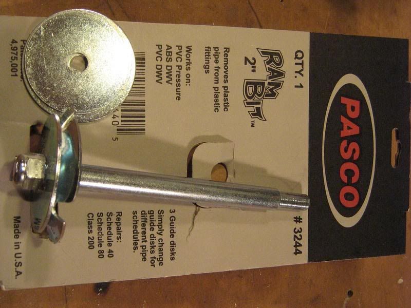

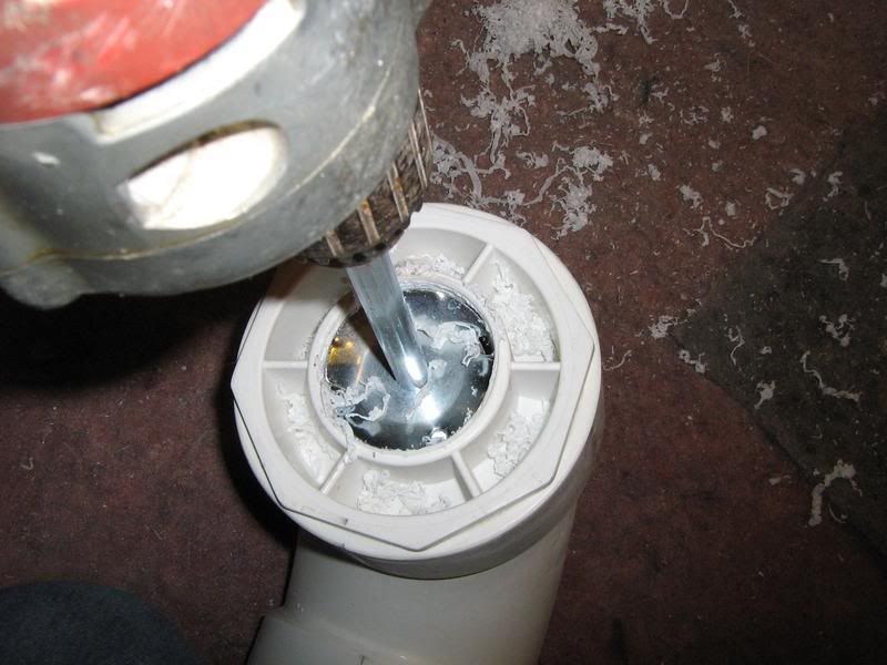

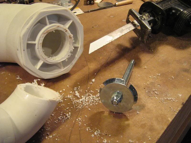

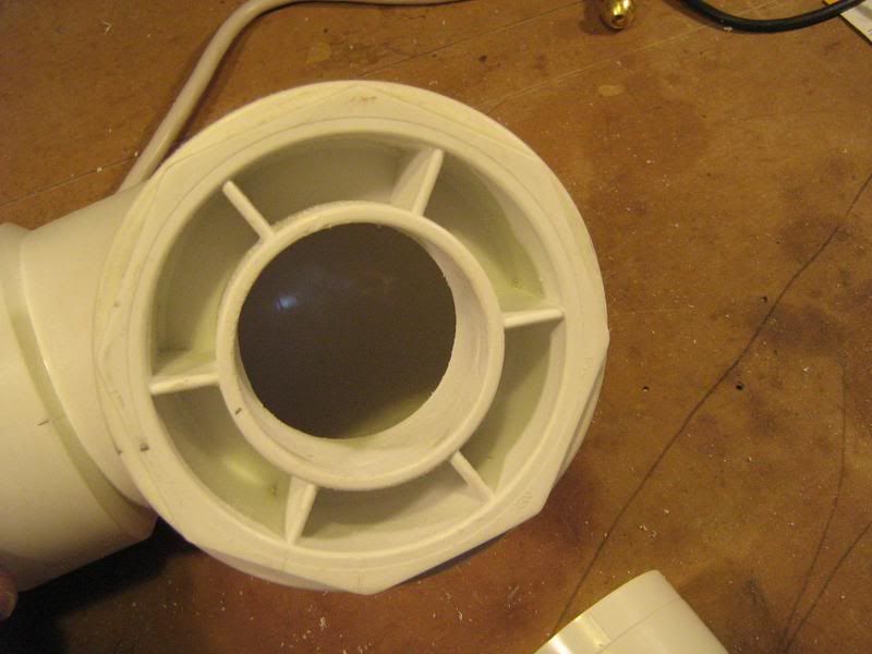

<img src="http://i116.photobucket.com/albums/o12/ ... G_0136.jpg" border="0"><img src="http://i116.photobucket.com/albums/o12/ ... G_0137.jpg" border="0"><img src="http://i116.photobucket.com/albums/o12/ ... G_0138.jpg" border="0"><img src="http://i116.photobucket.com/albums/o12/ ... 0145_2.jpg" border="0">[img]
I made a mistake on my new gun and found this drill bit.
The discs are spacers for diff. schs.[/img]

cool its clean and smooth at the end, you could use this to cleanout brushings and stuff instead of using a dremel.

hmm, good idea!iknowmy3tables wrote:cool its clean and smooth at the end, you could use this to cleanout brushings and stuff instead of using a dremel.
do they make them for 4-6" fittings?
then I'm sold!

i couldnt find any on that site.rmich732 wrote:www.plumbingsupply.com
does anyone know what sizes they come in?
EDIT: nevermind, im an idiot. : http://www.plumbingsupply.com/pvcsaver.html
they go all the way up to 4" and even have 1.5"!
awesome!
*places order*
