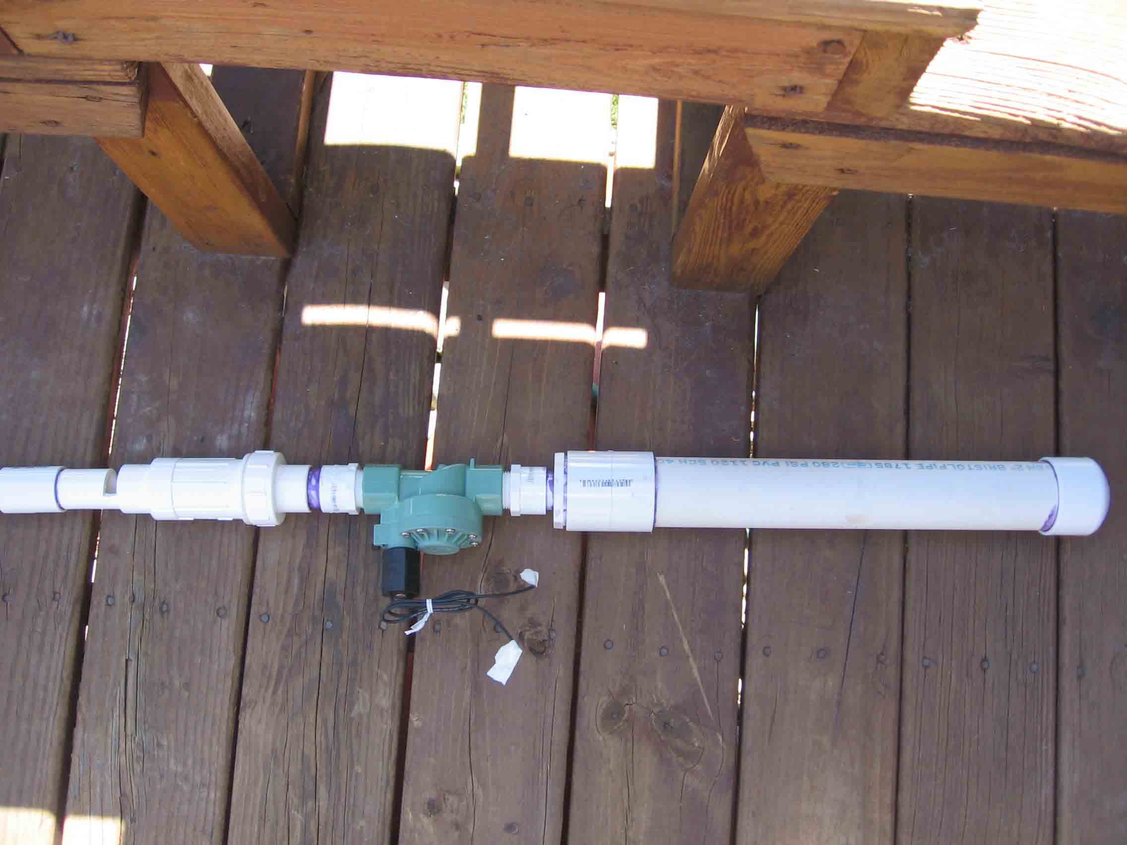

Barrel: 36" SCH 40 1" pipe
Chamber: 17" SCH 40 2" pipe
Fittings: ALL SCH 40

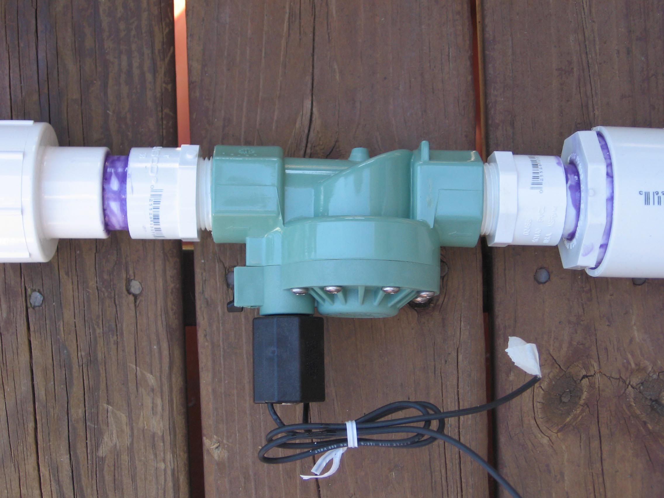

Valve: un-modded 1" orbit sprinkler (hopeing to mod just got to get off my butt and buy a blow gun
ACTION!!!: Pump - action

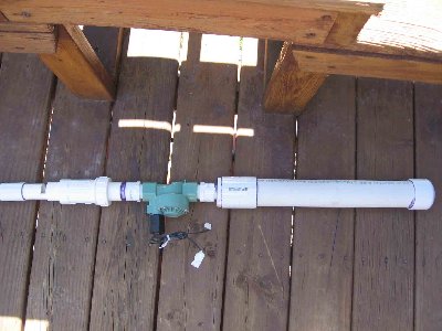

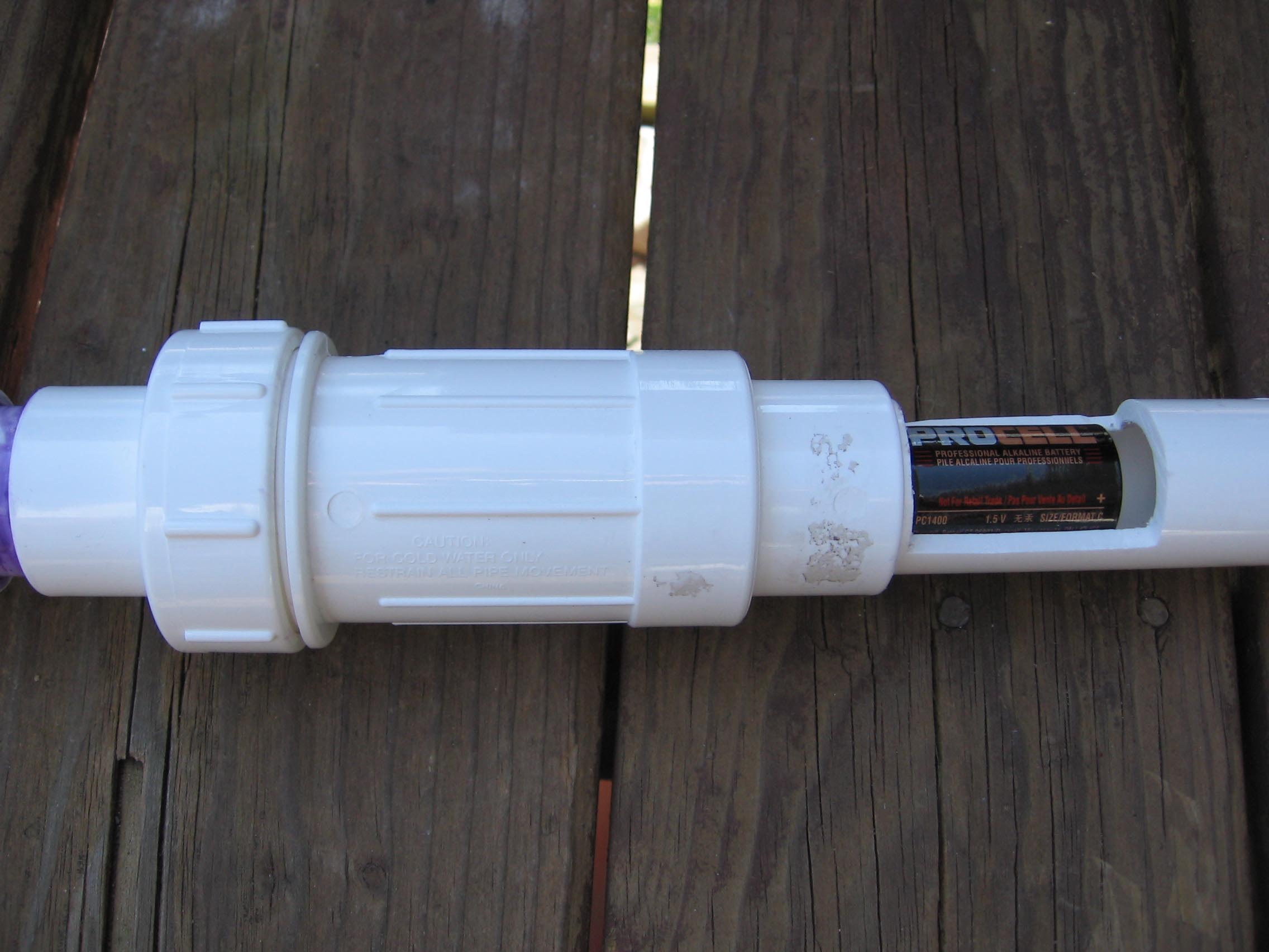

Yeah boy. This is my first pneumatic proud of the not to shabby primer job just a couple of places. Built it like 3 days ago. I have a bolt action thats made with a coupling fixer or something i forgot the name of it. Paint's coming, damage pics, and maybe a video.
GGDT said 250 FPS with 187 ft/lbs. with 100g projectile. What ever we'll see what it gets.
Oh yeah as i said im painting it, i still have to buy and install shrader valve (LOL), and im going to mod the sprinkler, maybe and o-ring to make that seal around the action better. So stay tuned.

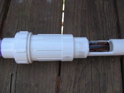

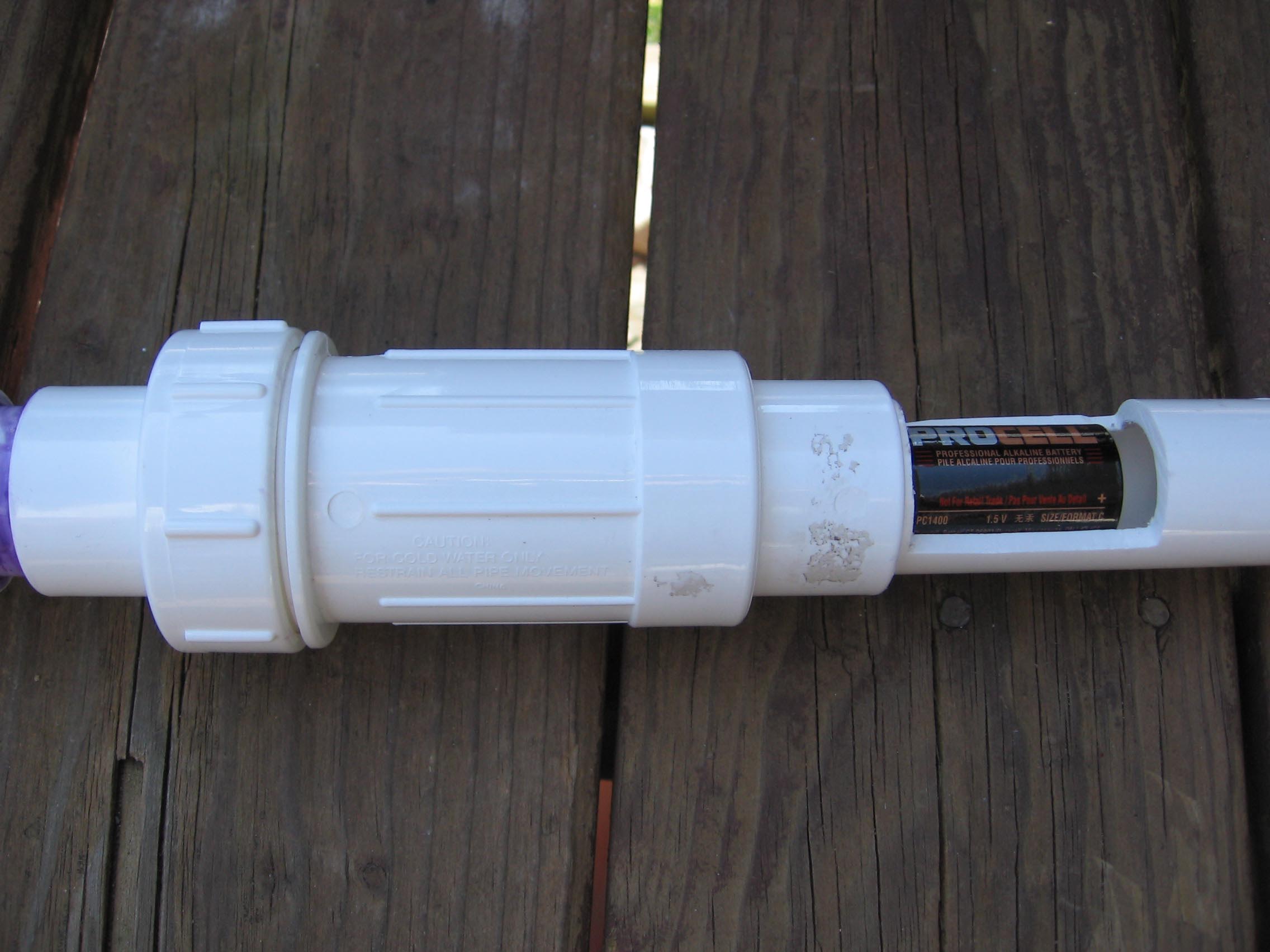

Inside of sliding coupling that is my heart and soul of the pump-action.

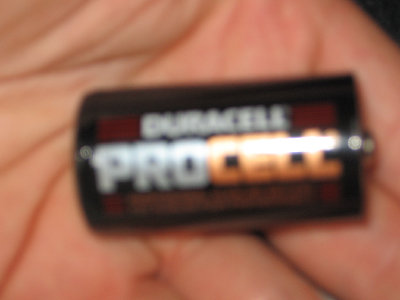

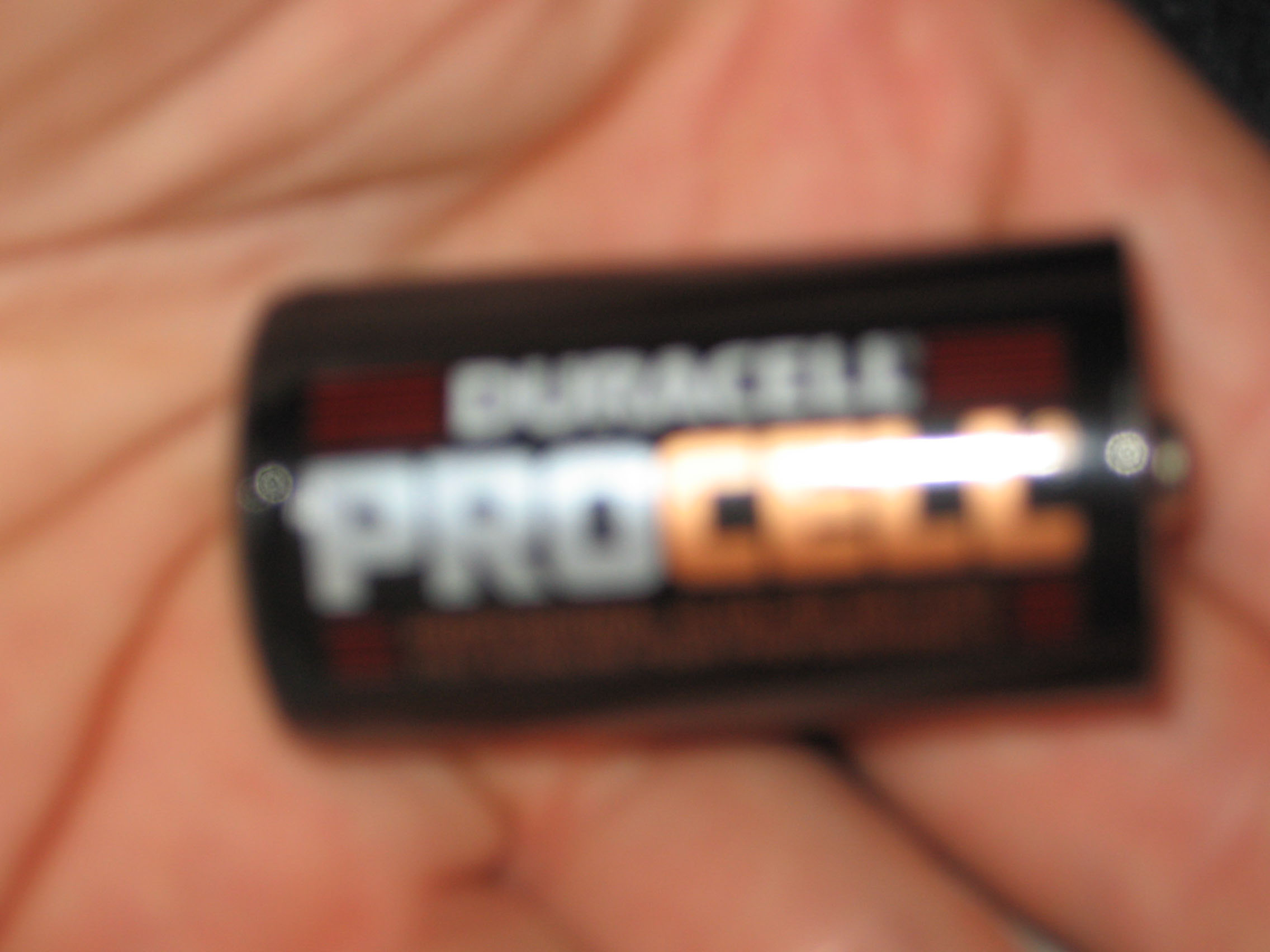

The main ammo.
The main ammo.

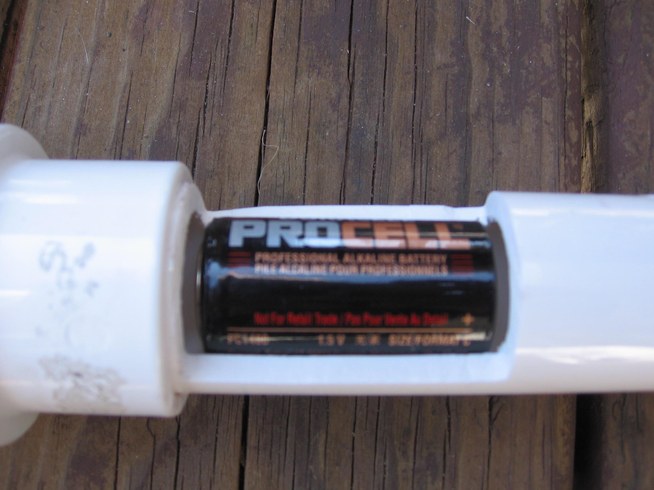

Opened pump action.
Opened pump action.
THE PUMP ACTION!!!!!!!

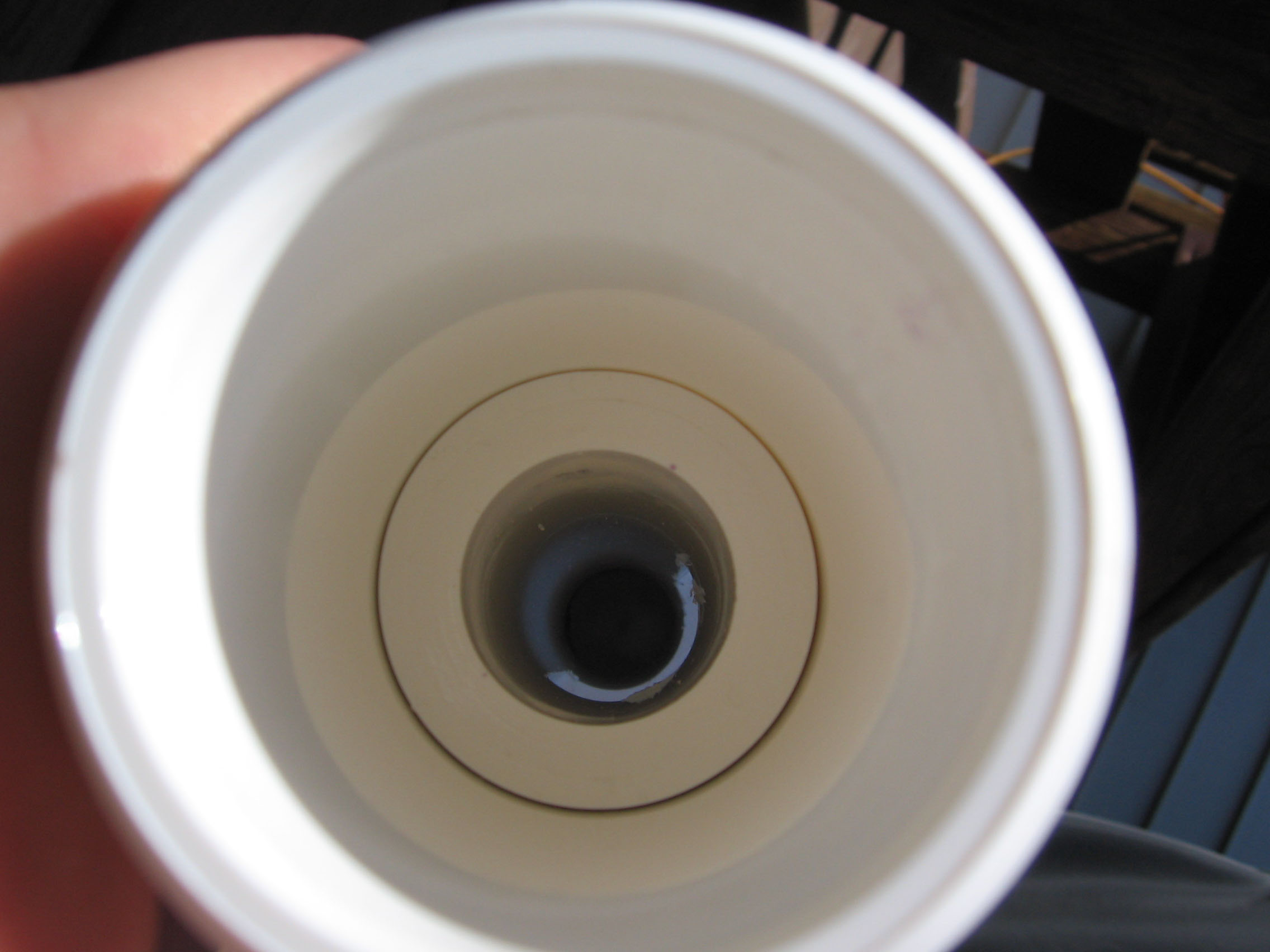

The valve.
The valve.
The gun.
The gun.

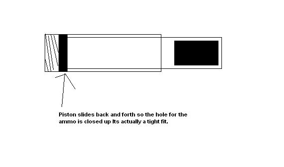

Basically you buy this repair coupling at the store and you'll know what to do when you see it , because it slides and you just cut and opening for your ammo. Mine had two o-rings one on the end of the screw cap, and two on the pison that slides.

before this post i put that breach on a just unscrewed before i shot. I dont understand how you stop the ''pump'' for locking and sealing.
I think ill stick to unscrewing it.

Its smooth and nice pumping maybe i can clear things up with a picture.

How does it lock though? mine doesnt lock it slides every shot. luckly i never sawed it.
