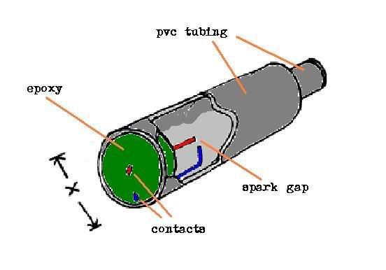

I suggest you look to combustions for a completely self contained, easy to make cartridge - here's one I designed and made:
and a video of it in action, with the spent cartridge ejecting:

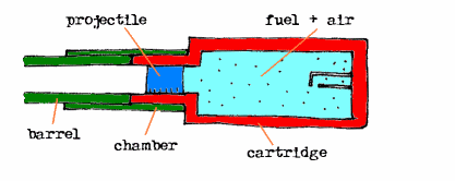

how it works:

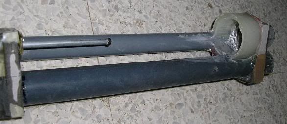

Even with a light projectile (I used a 3 gram shotgun wad in the video) enough pressure is generated to eject the cartridge, while still firing the projectile. As boilingleadbath assumed, I use a syringe to meter around 4 ml of butane/propane through the mouth of the cartridge.

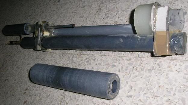

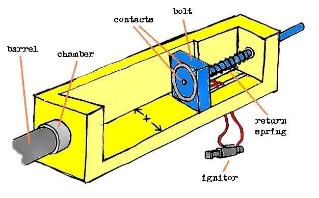

The idea was to incorporate the cartridge into a self-loading design, but there are a few snags - you can't have a spring loaded magazine, because this will create too much friction and not allow the cartridge to eject. This means that the next round has to be gravity fed, but the problem is that it doesn't feed fast enough to be seated by the returning breech if it's spring loaded. What I did therefore was to have a pneumatic piston that returned slower than a spring and whose compression could be varied by altering the reservoir pressure.
The original design:
final prototype with pneumatic breech:
