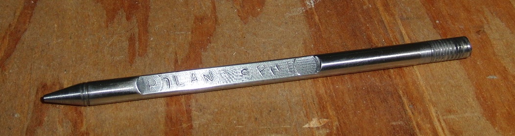

A-98 wrote:see, thats my problem, i cant have anything coming out of it. hell, the barrel isnt even coming out of it. just a stub. im having to make my own plus out of epoxy
That would be a cartridge then :wink:
I used a syringe to meter butane into my carts quite successfully, from a lighter refill can:
