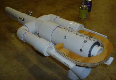

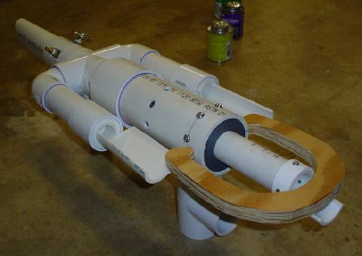

To avoid having to have a huge barrel and awkward sabot, I had a reusable piston device on my horseshoe launcher. As you can see, there is a large amount of barrel dedicated to stopping the piston (everything after the holes)
