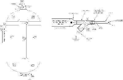

This is a rough sketch of my design for a flame thrower. It's made of PVC and brass parts and fittings, and will be pressurized with propane.

This drawing should be reasonably self-explanatory.

Here's the tank:
Here's the "gun":
If you have any questions let me know.

Very nice design. Did you do those diagrams in Msft Visio?

Thanks. Yeah, they're done in visio.

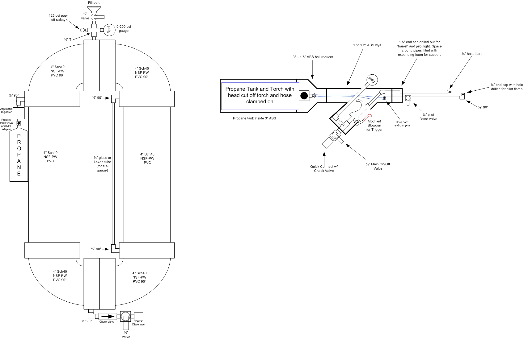

Here's a higher resolution diagram with more labels.
By the way, the plastic pipe on the "gun" part is just "furniture", so any kind of pipe will do (I use ABS cause I have a lot of it laying around). The "barrel" and "pilot" tubes are 1/4".

Here's the parts list, as promised:
Tank - ALL PVC MUST BE PRESSURE RATED NSF-PW!!!
4x 4" Sch40 90-degree NSF-PW
5ft 4" sch40 NSF-PW PVC pipe
4x brass 1/2" 90 degree, male threads on one side, femal threads on the other
7x brass 1/2" close nipple
1x brass 1/2" 4-way T
1x 1/2" - 1/4" reducer bushing
1x 1/4" 0-200 psi pressure gauge
1x 1/2" 125-psi pop-off safety (1/4" would work but 1/2" is prefered. if you use 1/4", you need another 1/2" - 1/4" reducer bushing)
1/2" - 1" reducer bushing (used as funnel for fill valve)
2x 1/2" brass ball valve
1x 1/2" brass check valve
1x 1/2" quick-connect (male and female)
1x adjustable regulator
1x propane tank adapter ( http://www.bcvids.com/store/product_inf ... ucts_id=39 )
1x 1/2" pyrex glass or lexan tube (try lab supply stores, stores that specialize in plastic parts, or ebay)
benzomatic propane canisters (get several....)
"Gun"
Plastic parts here don't hold any pressure, so any kind (DWV, ABS, whatever) will do. I like ABS, it's cheap, and it's black so you don't need to paint it :)
Housing:
1ft 3" (propane tank holder)
1x 3" - 1.5" bell reducer
1x 1.5" x 2" wye
Internals:
1x 1/2" quick connect set (male and female)
1x 1/2" ball valve
1x 1/2" x 1/4" Tee (the one right before the blowgun, to hook up the pressure gauge)
2x 1/4" brass 90 degree
1x 1/4" brass nipple (for mounting gauge on. length depends on "stock" size)
1x 1/4" 0-200 psi gauge
1x blowgun
1x 1/4" nipple (blowgun to 45 degree piece)
1x 1/4" 45 degree brass peice (these are hard to find at hardware stores - try speciality plumbing supply stores or online)
1x 1/4" close nipple
1x 1/4" end cap
2x" 1/4" hose barb
4x hose clamps
2ft 1/4" pressure-rated hose (needs to be able to take 125+ psi, for the pilot light)
1x 1/4" ball valve (pilot light control valve)
brass/copper pipe for "barrel" and pilot light tube, length to taste
Misc. supplies and tools:
PVC primer and glue (make sure it's reasonably fresh, and the right kind for the pipe you're using)
Sand paper (for rouging up the PVC fittings a bit before gluing them)
Teflon tape (for the brass fittings and pipe)
Wrenches (for screwing together the brass fittings and pipe)
High-strength epoxy
Expanding foam
1/2" tap and die set
drill bits
drill
rubber mallet (for tapping plastic fittings into place)
screwdriver(s)
air compressor or bike pump and a way to connect it to the tank for pressure testing
For cutting pipe, there are lots of ways to go about it - an actual pipe cutter (like this: http://www.ridgid.com/Tools/Heav-Duty-P ... /index.htm ) is best but one of these that can do 4" pipe is expensive as crap. A table saw is the next best bet - just mark where you want to cut, set the blade to the appropriate depth, put one end against the fence, and turn the pipe slowly on the table saw. If you don't have a table saw, you can cut the pipe with a hack saw, but it's very difficult to get a perfectly straight cut. Smooth it out as best you can with a file and/or sandpaper.

uhhh.... you don't want a pressure pop off in a flamethrower. The last thing you want is fuel coming out the side while using it. anyways, propane can't reach a high enough pressure to cause worry if you are using pressure rated pipe and proper solvent cementing. also, just use gasoline it is cheap and safe to use with pvc pipe.
Also, why worry about backflash if it is pressure rated?
Your fuel gauge should be made from clear plastic tubing... cheaper and can take the pressure. Make it a "loop" with an elbow and nipple at the bottom of the chamber and one at the top, then attach the hose with clamps and make sure you pressure test it. At least that is what i did on my flamethrower...
Don't need a regulator.. just rely on propane vapor pressure tables. As I stated pressure rated pvc can take propane's pressure.
You never mention Teflon tape but instead recommend epoxy which is a poor choice.
you know some stuff but you are also retarded about other stuff.
how long are the 4" pipes?
You obviously did not consult my building supply list or you have known there are cheaper places to get propane throwaway adapters.
http://www.freewebtown.com/flyingsloths ... opaneadapt

The 125-psi pop-off should never need to open. With a propane regulator (which I know is not required but allows better control over pressure), the pressure in the tank should never go above 100psi. Use a 150psi pop-off instead if you're worried about that happening.
I know that since it's pressurized with propane and the tank is all NSF-PW, there's almost zero chance of backflash, and if it DID happen, odds are nothing would fail violently.
But since we're talking about putting a bunch of PVC parts pressurized with flammable gas and fuel on our backs, safety is my #1 concern. That's why I use the check valves, and etc...
Your idea for using plastic tubing instead of glass/pyrex/plastic for the sight tube is a good idea for those that might have trouble finding other parts. I can get Lexan tubing cheap from a place called Tap Plastics, so I just use that. If that wasn't available, I'd use your idea.
I do indeed mention Teflon tape... read carefully. However, I also put some epoxy on the very tip of the threads when inserting a fitting into tapped PVC. Epoxy is also very useful for many other things....
The 4" pipes are as long as you want to make them and still have them comfortably fit in a backpack. I used ones about 24" on each side, of course with short sections of 4" between the 90 degree pieces.
I wasn't necessarily suggesting buying the propane adapter there, just giving an example of one. But it's really not much more expensive than anywhere else... If someone wanted to, they could also just use a short piece of hose, a hose barb, and some clamps instead of the adapter...
May I ask what I'm "retarded" about?

Well, propane is only about 70-80 psi, so having that valve shouldn't be a problem. Backflash probably wouldn't do anything, but then again, it may render your flamethrower useless due to the small size of the nozzle. So, as long as the valve only pops when you have backflash, then your good.
Instead of using foam, I would have put an end cap, with holes drilled through it for the nozzle and pilot light. Then, I would have sealed it with silicone caulk.
EDIT: Oh yeah, and backflash would only happen when your fuel tank is almost empty anyway.

back flashes in a flamethrower pressurized with propane are physically impossible. And like I said... even if it somehow did happen magically, you are in no danger. (unless if you have a pop off valve which will eject burning gases and liquids) It would actually be to your advantage, as it would add pressure to the flamethrower effectively recharging it.
btw my flamethrower uses two 5 foot sections of 4" pvc pipe for the chambers. about 3.8 gallon capacity. :twisted:

ammosmoke wrote:Well, propane is only about 70-80 psi, so having that valve shouldn't be a problem. Backflash probably wouldn't do anything, but then again, it may render your flamethrower useless due to the small size of the nozzle. So, as long as the valve only pops when you have backflash, then your good.
Actually propane pressure is 100% dependent on temperature: http://www.engineeringtoolbox.com/propa ... _1020.html
At 70F, propane is around 110psi. On that note, a 150-psi pop-off would be a better bet than a 125...
You're right, backflash could only occur when the tank is almost completely empty. Even in that case, the maximum pressure generated by such a combustion should be well under 100psi, so the odds of a catostrophic failure are very low.
The silicone caulk idea isnt bad. The expanding foam is just to keep the "barrel" and pilot light tubes still and steady, anything similar would work.

um, may i point out that your tank drawing are not pressure rated? you say they are, but thats more un-pressure rated than a panda. poor things cant handle stress.... :lol:

It's just a diagram done in Visio, drawn mostly by hand. I say in the instructions to use NOTHING but pressure-rated NSF-PW sch40 PVC for the tank. I suppose I didn't draw the sockets deep enough?

general lack of common sense. the back flash/regulator/pop-off valve bit showed some of it. As did the fuel level gauge made of glass.
