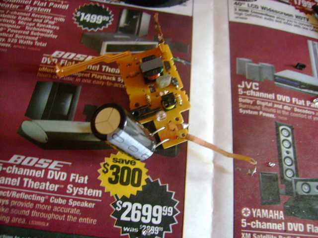

I have a camera flash circuit (pictured below) and I want to use it as an ignition source. The only problem is, how?
Can someone explain to me where I put the two wires that go to my chamber and where to install the pushbutton? Thanks.

How can I charge the circuit? Without doing all that stuff to it?

There should be a small pressure pad somewhere on the circuit, you would usually press that to charge the cap. You can try removing that, and soldering a switch in place, or just permanently solder wires to jumper it and place the switch at the voltage source instead-this is usually easier.
To discharge the cap, you can just solder two wires to the terminals and connect them to whatever with a push switch.
The 200V from the circuit alone won't produce a nice spark, you need to either step up the voltage, or ionize a path of air between the electrodes.
Heres one example of a set up
http://www.spudfiles.com/forums/camera- ... t4611.html
Unfortunantly it tends to be pissy about working. I prefer to screw a screw in and then drill a hole next to it and insert a nail with a spring. Connect both to seperate leads from the capacitor, and then charge the cap, and press the nail down to get a nice pop. Never had a falure with this set up.
You can also get and igniton coil and discharge a capacitor into the coil to produce a nice spark. Might do a how to on it eventually.

I think I'll try it your way first... Except I'm using it for a mini and the wires have to be right next t each other... I am using 100% silver wire though, from an old computer PSU... Will it short out?

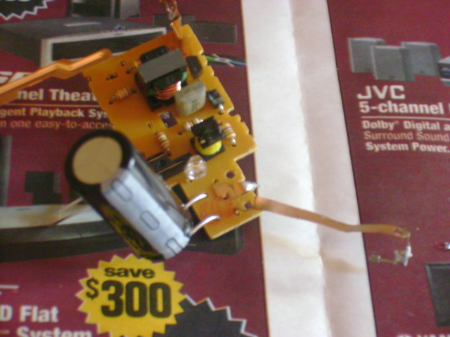

You can see the two contacts of a leaf switch on the left of the picture.
Thats the trigger to dump the small, silvery, rectangular capacitor though a small cylindrical transformer to ionise the air between the two capacitor leads. Thats where the pushbutton should be connected.
You should have three wires/terminals besides the battery connections.
Two wires/terminals would have been attached to the flash bulb.
One would have been either a rather thicker insulated wire or a copper strip of some sort, going to the metal reflector around the flash bulb.
To have the pushbutton trigger the spark you have to have the two flashbulb wires mounted close to each other and the third trigger wire arranged around the gap between them.
So when the circuit is charged, pressing the pushbutton ionises the air between the flashbulb wires and the spark jumps.
The gap should only be about 1-2mm.
If there's a push pad or the like which has to be pressed down to charge the capacitor, solder it together and have the on-off switch with the battery connections.
The transformer on it has too many pins and because of that I usually end up breaking some of them when trying to desolder it.
Give me a kodak board with a 5 pin transformer any day.
I can rig up a tiny capacitor charging circuit with one transformer, one transistor, a resistor and a diode from a kodak board
Back on topic.
