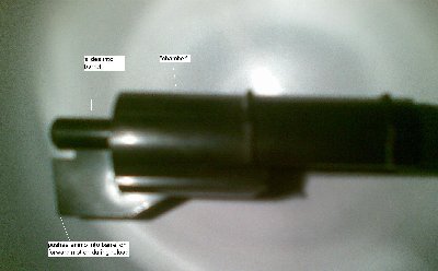

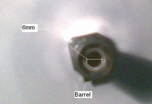

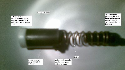

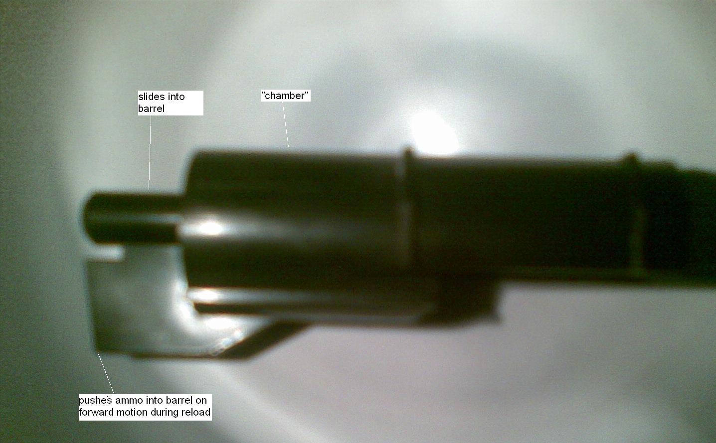

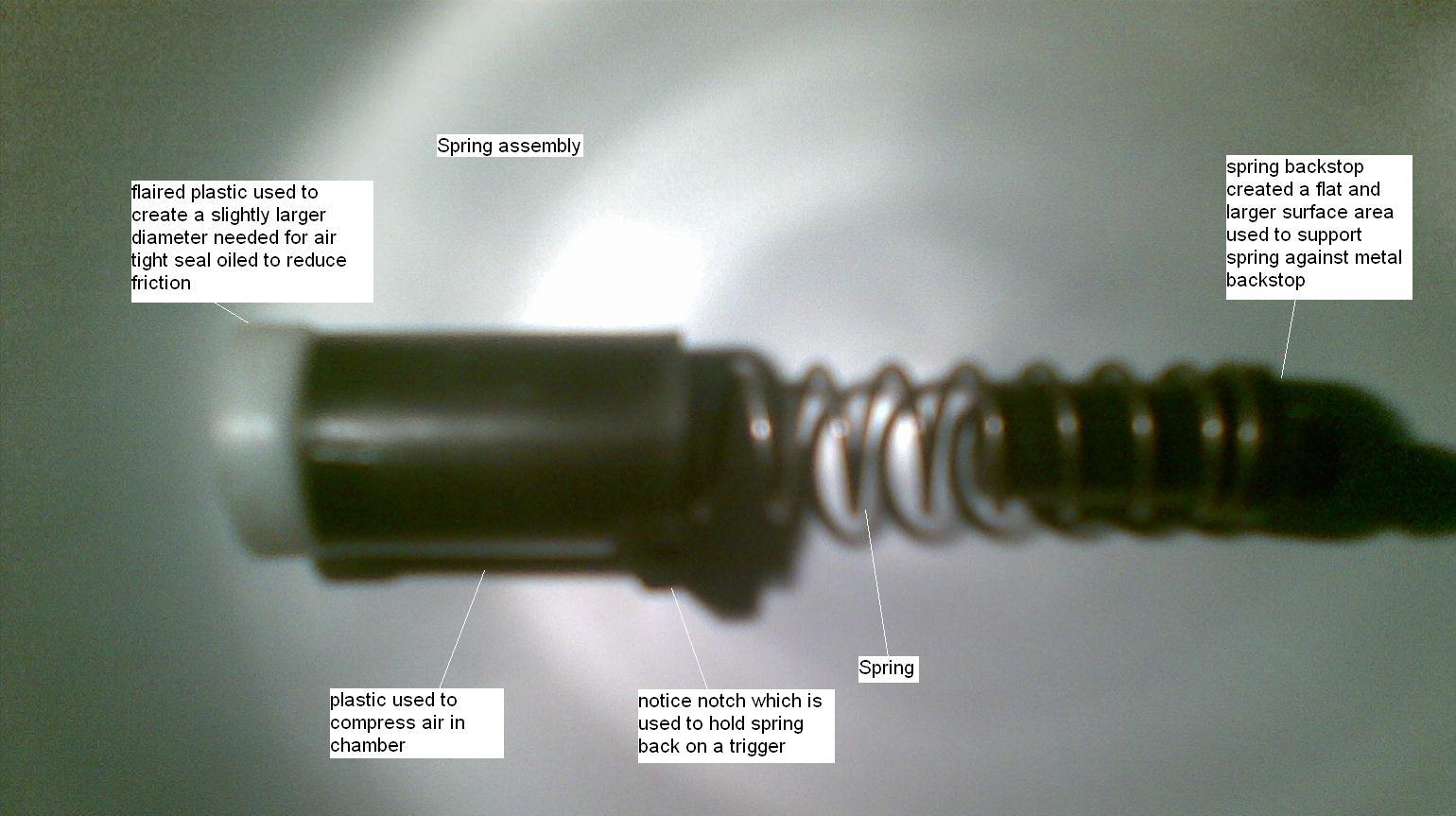

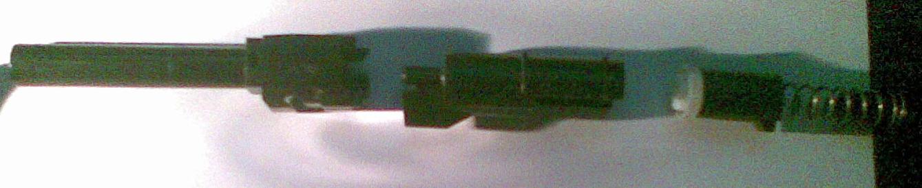

while i would prefer a fully auto bb gun using an air compressor, what sniper josh is saying is correct, also note that your maximum projectile velocity will be severly limmited i would say around 120 - 200 FPS for a 0.012 g projectile (std BB gun ammunition) approx. 20FPS slower for the heavier 0.2 g projectiles. anyway here are some pics of the internals of my BB gun, this should give you some ideas on how to create yours. n.b. i have left out the trigger mechanism as it is very complex in my BB gun i also lack plans.
sorry abould the shocking quality
i forgot to mention that you should aim to have the lightest materials possible in the construction of your means of compressing air as it is required to mover very fast to generate any considerable pressure
order of assembly
order of assembly
spring assembly
spring assembly
chamber
chamber
Barrel
Barrel
