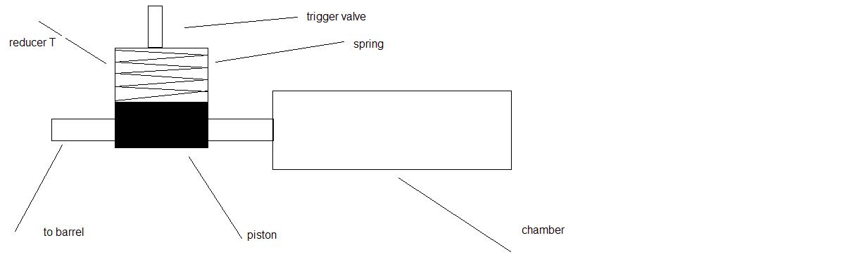

I'm not sure if this a good idea or not??? I just stumbled upon this design when I was looking at a squirt gun valve. Funny eh?? I made a VERY, small model and tested it at about 60 psi no leaks at all. I was hesitant to post this here because I wasn't sure if anyone had done anything like this valve design before. It can be fired as a semi-auto valve if the chamber is large enough, and under enough pressure.
- This is it, it's actually pretty simple. I think it's similar to Clide's idea.
- semi auto.JPG (23.15 KiB) Viewed 7653 times

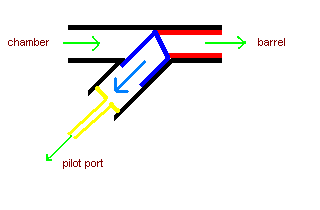

Hi,
Thanks for all the responses. That's where inspiration comes from...
With a 67.5 degree cut, the length:width of the piston and the barrel end becomes the same ---> better fit, smaller piston.
With a 45 degrees barrel cut, one will then need a piston diameter quite a lot larger than the barrel diameter - but ok that brings us back to:
But ok it WILL be a somewhat large piston for the barrel. Something like 71 mm piston OD for a 50 mm barrel OD. On the other hand, construction is simple (90 degrees piston end).
What is a good piston surface area : sealed face area for barrel sealers?
Maybe the best cut is somewhere in between 67.5 degrees and 45 degrees.

Mostly to avoid a big fat pipe coming off to the chamber at an odd angle. I can't find any 45 deg bends to straighten it up. Of course one could use another wye ...Why put the piston in the bottom pipe that splits off? Why not assemble it like a regular piston valve, with the pilot being parallel with the barrel, and the chamber coming (45* instead with the Wye) off the bottom?
Wait wait that's actually a good idea. I did design like that originally. The problem is that the 45 deg barrel cut becomes sqrt(2) times longer than it is wide.Although I would suggest that you make the piston a normal one with a 90° face and use a 45° sealing face in the wye. That way you wont have to worry about the piston trying to slide off the sealing face, which was one of my problems in the regular tee.
I drew up the situation. Maybe there is a single solution for both problems.Well the piston wouldn't work anyway in that diagram as the seat diameter = the sealing face diameter, so make the seat have a smaller diameter compared to the sealing face and then you practically have got what clide made.
noname, have you revealed somewhere what is inside that valve of yours?
