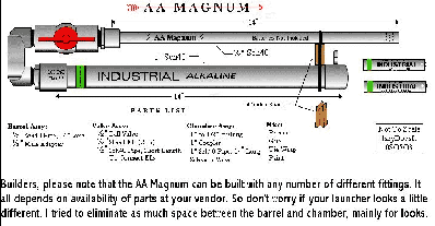

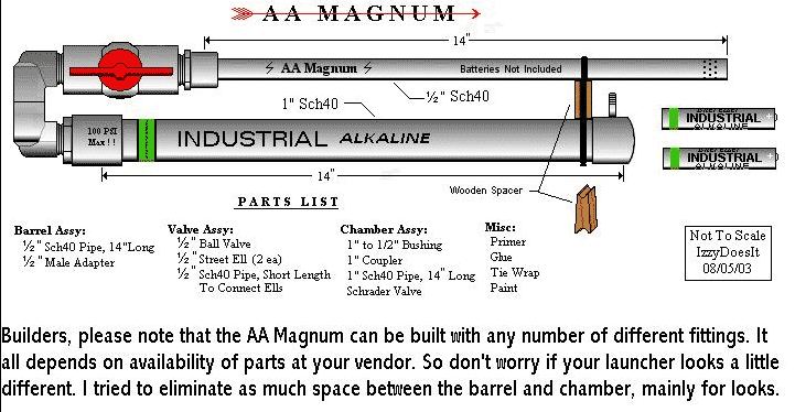

the ball valve should be upgraded to a sprinkler valve...
syco kilaa
Posts: 66
Joined: Wed Dec 29, 2004 11:01 am
Location: Raleigh, NC
true true, and I think that there should be a pressure guage as well as moving the schrader valve to the end of the chamber.
NEGATIVE
DriftingRz
Posts: 58
Joined: Sun Sep 25, 2005 9:28 pm
can some one match all the peices in the pic with the name i dont know some of the names, why would he need to upgrade to a sprinkler valve, how would you do the pressure guage. im new
Thanks
rna_duelers
Posts: 1739
Location: G-land Australia
Just useing a tapping and dire set to attach the guage shouldn't be to much trouble..and if u want to keep it cheap a ball vavle will do for a while until u want that extra power and most of all wat u loose when u have a ball valve..acuarcy even though they r smooth bore and aiming would be nearly imposible with batteries due to lack of airodynamics but i would go for the sprinkler valve upgrade personaly..and i am also new here:) :)
