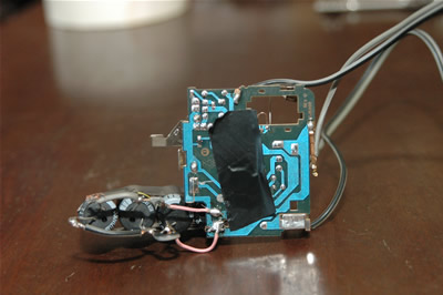

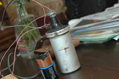

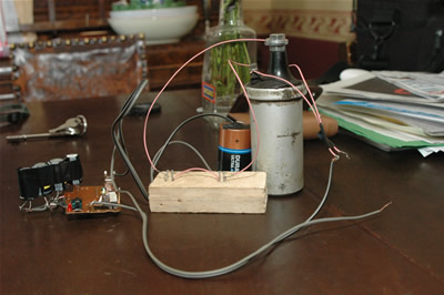

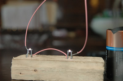

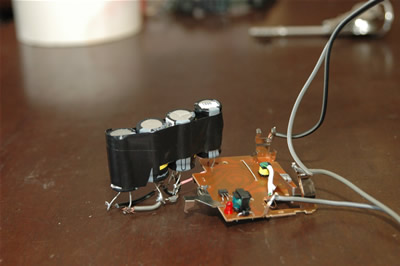

I just made this ignition device using an old 6 volt ignition coil from my dads BSA lightning rocket that he sold. I used a homemade camera flash circuit whith 4 capacitors wired in parallel dumping in to the ignition coil. It gives a really nice fat white spark about half an inch long. I've also made a basic dual ignition system on a bit of wood (see below) whith two 1/4inch spark gaps. I probally won't use this on a cannon it was just an experiment. Post your ignition devices! :headbang:
- The sparks
- DSC_0522.JPG (18.65 KiB) Viewed 3708 times
- the ignition coil
- DSC_0512.JPG (28.1 KiB) Viewed 3709 times
- the camera circuit
- DSC_0509.JPG (25.18 KiB) Viewed 3709 times
- DSC_0508-1.JPG (21.69 KiB) Viewed 3709 times
- the whole system
- DSC_0506.JPG (30.13 KiB) Viewed 3709 times

Hi I'm not using a flash tube, I'm just using a spark gap. I'm just using the camera circuit to power the ignition coil.
