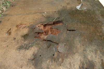

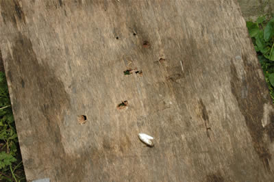

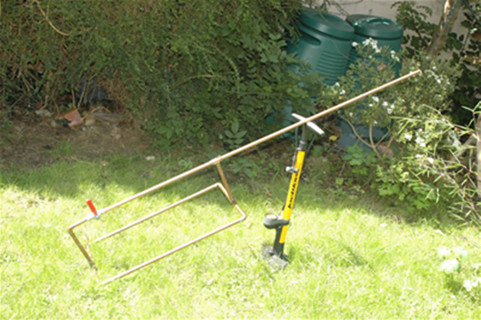

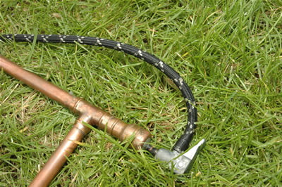

Hey this is my first cannon it's a copper pneumatic one using a ball valve. It's all 15mm. I've taken it up to 160psi with my joe blow sports pump. To put the schrader valve in I stripped the rubber off in a drill, unscrewed the poppet sooldered it in and put teh poppet back. I t was my first go at soldering so don't be to harsh. The most damage I've ever done was a nut and bolt through 6 ply and 1/2innch mdf.
Stats
Chamber: 7 feet of 15mm
Barrel: 5 feet of 15mm
Valve: ball valve 15mm
Filling valve: tyre valve

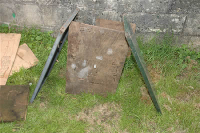

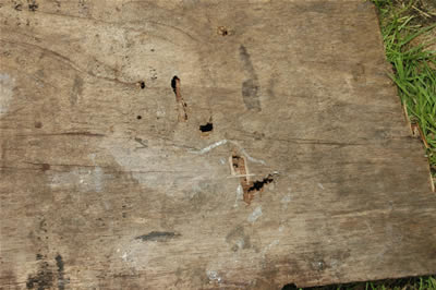

nail dart through ply
Picture 104.jpg (36.32 KiB) Viewed 2835 times
my target
my target
Picture 103.jpg (25.46 KiB) Viewed 2835 times
the back of the ply
the back of the ply
Picture 102.jpg (33.28 KiB) Viewed 2835 times
another bit of ply 36 feet
Picture 101.jpg (22.75 KiB) Viewed 2835 times
the back of it
the back of it
Picture 100.jpg (30.98 KiB) Viewed 2835 times

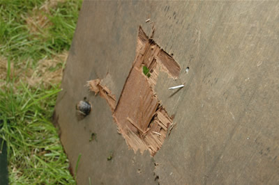

sheet of 6 ply at 36 feet
Picture 099.jpg (23.8 KiB) Viewed 2835 times

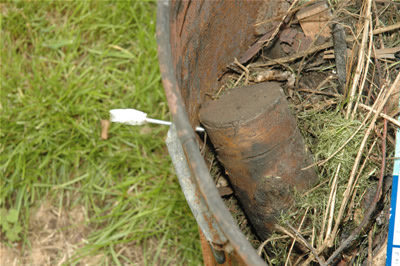

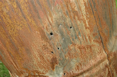

damage to the bin
damage to the bin
Picture 098.jpg (33.68 KiB) Viewed 2835 times

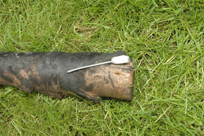

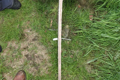

the ammo
the ammo
the filling corner
the filling corner
another view, the nail went about an inch into the wood and i got dad to yank it out whith some monkey wrenches

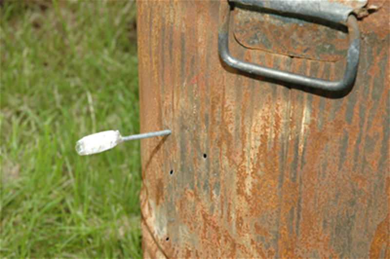

Nail dart through metal bin
the cannon and the pump

WOW! :wav: :occasion5: :headbang: Thats so awesome I forgot to jump up and down... Yeah, its OK. Why the massive amounts of copper at the bottom though?

very nice, but you could make the chamber with 22mm pipe for quite a bit more volume:) and iff possibale you could spring load the ball valve to speed up opening times!

I was originally going to buy a schrader that fits into a 22mmm endcap.
And spanerman, I got the stuff at homebase and they only sold 22mm copper in 30m lengths for £113...I probally will springload the valve[/quote]
