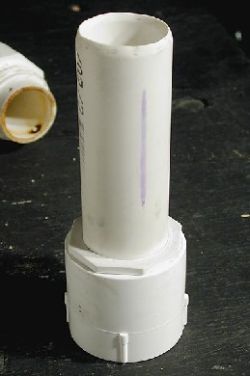

A '''spud cutter''' or '''muzzle knife''' is used to cut produce to the diameter of the barrel. It can be made as an integral part of the barrel, or kept as a separate utensil.
A '''spud cutter''' or '''muzzle knife''' is used to cut produce to the diameter of the [[barrel]]. It can be made as an integral part of the barrel, or kept as a separate utensil.
It is made by beveling the outside of the barrel until it forms a sharp edge. In [[combustion cannon|combustions]], is recommended that you add an inner chamfer to your launcher; this cuts a tighter fitting projectile, which increaes friction and therefore acts a bit like a [[burst disk]], allowing the pressure to build before projectile starts to move.
It is made by beveling the outside of the barrel (or a pipe of the same inside diameter) until it forms a sharp edge. In [[combustion cannon|combustions]], is recommended that you add an inner chamfer to your launcher; this cuts a tighter fitting projectile, which increases friction and therefore acts a bit like a [[burst disk]], allowing the [[pressure]] to build before projectile starts to move.
However, there are deficiencies in the typical PVC 'cutter, mainly that it is a relatively soft material and therefore can neither be sharpened very well nor hold an edge. Many have attempted to counter this by:
* Serrating their cutter. (Examples: [http://www.spudfiles.com/official_pics/loc_04.jpg], [https://netfiles.uiuc.edu/hanson2/www/Misc%20Cannon/P8213916.jpg])
* Serrating their cutter. (Examples: [http://www.spudfiles.com/official_pics/loc_04.jpg])
* Making them out of steel. ([http://www.spudfiles.com/forums/viewtopic.php?t=775 at risk of promoting my own product...])

A spud cutter or muzzle knife is used to cut produce to the diameter of the barrel. It can be made as an integral part of the barrel, or kept as a separate utensil.
It is made by beveling the outside of the barrel (or a pipe of the same inside diameter) until it forms a sharp edge. In combustions, is recommended that you add an inner chamfer to your launcher; this cuts a tighter fitting projectile, which increases friction and therefore acts a bit like a burst disk, allowing the pressure to build before projectile starts to move.
  • Serrating their cutter. (Examples: [1])
  • Making them out of steel.
