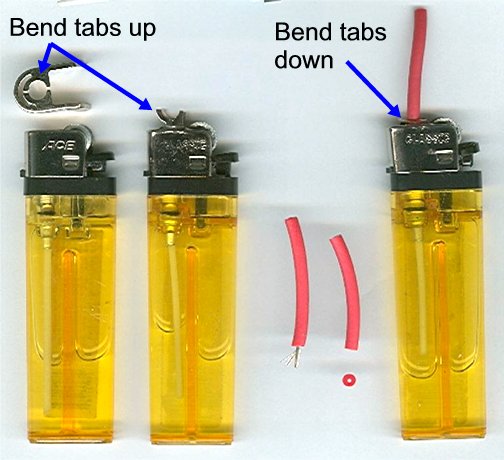

[[image:StepsAnnotated.jpg|frame|left|Attaching the tubing to the lighter. (see [http://www.inpharmix.com/jps/Fuel%20Meter%20From%20A%20Disposable%20Butane%20Lighter.html  A Fuel Meter From A Disposable Butane Lighter])]]

Attaching the tubing to the lighter. (see A Fuel Meter From A Disposable Butane Lighter)
