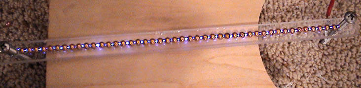

An etched copper spark strip
A spark strip is used to provide multiple sparks to ignite the fuel/air mix in a combustion launcher. It is differs from multiple spark gaps in that a spark strip is mounted using two or even one (temp link) hole. This is done primarily to ensure the integrity of the launcher, as drilling multiple holes weakens the chamber. Spark strips can also be used in coaxial launchers, where chamber space is more cramped.
A spark strip consists of several conductive objects in a row with a short gap in between, effectively forming a line of spark gaps. As with other spark gaps, the combined width of the gaps must be small enough for the ignition source to overcome.

Examples:
BB spark strip
Wire, etched and veroboard spark strips
