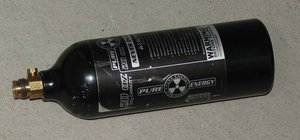

Paintball tanks
A CO2 paintball tank
Paintball tanks come in sizes from 4 to 20 oz, which is the weight of the CO2 the tank can hold. The tank valve is either a pin valve, which is opened by screwing the tank into the fitting, or an on/off valve which can be opened and closed manually. They have a burst disk safety valve that will break and vent the CO2 if the tank pressure rises above a certain limit.
