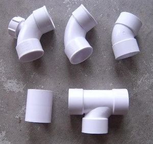

DWV Fittings:
DWV PVC fittings have a few obvious traits that you can use to identify them.
Non Pressure Rated PVC Fittings (DWV)
  • Shallow sockets, DWV fittings have shorter socket depths in their fittings.
  • Ring around fitting, DWV fittings usually have a 'ring' around the outside of the sockets, Pressure Rated fittings, don't.
  • Thickness, DWV fittings and pipe are very thin compared to their Pressure Rated counterparts.
  • Odd shape, some DWV fittings look very odd and drastically different to Pressure Rated fittings.
