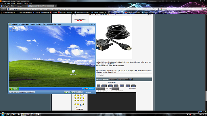

I would use a virtual machine to run Ubuntu inside windows, it is easy...
here you can see me running xp inside win 7
and al-xg is correct 3d modeling is easy to learn in these days, also you don't really have to know g-code since the software generates it from the 3D model, well that is at least how I understand it (I may be wrong)

I would think this is a safer solution. Or even a multi I/O PCI card.
http://www.newegg.com/Product/Product.a ... rx5a3zglmx
Some of the cable adapter solutions have been known not to not fully compatible, such as bidirectional control, especially if the device needs it.
Read some information here;
http://www.rcgroups.com/forums/showthread.php?t=1238773
Note; Mach3 software does not agree with Win7 64 bit!
I recommend a cheap P3 or P4 laptop with parallel port and XP 32 bit OS just to protect your new PC system.

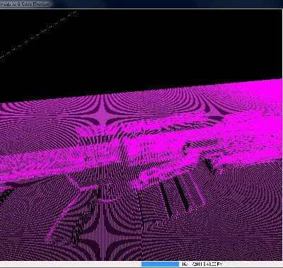

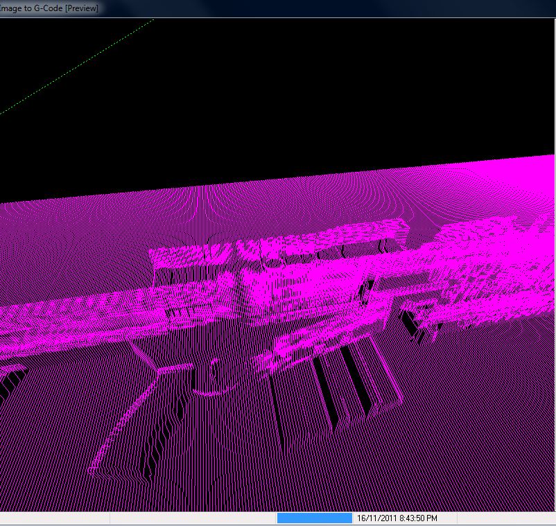

A simple example of why this topic applies to Spuds. Many of us dream of making the perfect "copy"; a BFG that actually looks like a BFG rather than a plumbers nightmare.
So.........
Start with a suitable image
Apply a nifty program called Image to G Code
Feed the G Code to your CNC router
Load the router with some material like a sheet of HDPE 25mm 1200x600 that most of us have under the bench :)
Presto, out comes the grips, stock, receiver etc that we dreamed of.
19,000 lines of G-Code that look like this:

Picture examples herewith.
Scan it with I2GC
Scan it with I2GC
Choose an image file

Evil,
If only it was that easy. What you describe is surfacing. Great for making Starbuck logos, small trinkets, visual appeal stuff. It would be great for making thermoform molds. For a "real" part, you gotta go CAD CAM for now. In a few years, that may change with manufacturing information embedded in drawings. For now, a 2 or 3D drawing to work from is hard to beat. All the current systems are geared that way. I am looking forward to drawing files JSR can e-mail to us for manufacture. (Finally):D

@USGF
Sorry, have to disagree.
Yes, I simplified it a bit, what I tend to do is feed the G-Code via CAM/BAM then into Mach 3 for the actual job.
This is exactly the technique I have used to produce actual 3D parts.
Not surfacing, the mill cuts all the way through apart from holding tabs. The thing to remember that you are making 2D sections that become 3D. To make a stock, I cut two mirror halves, each 50% of the final thickness required. Cut the mirror images, then laminate them for the finished result.
