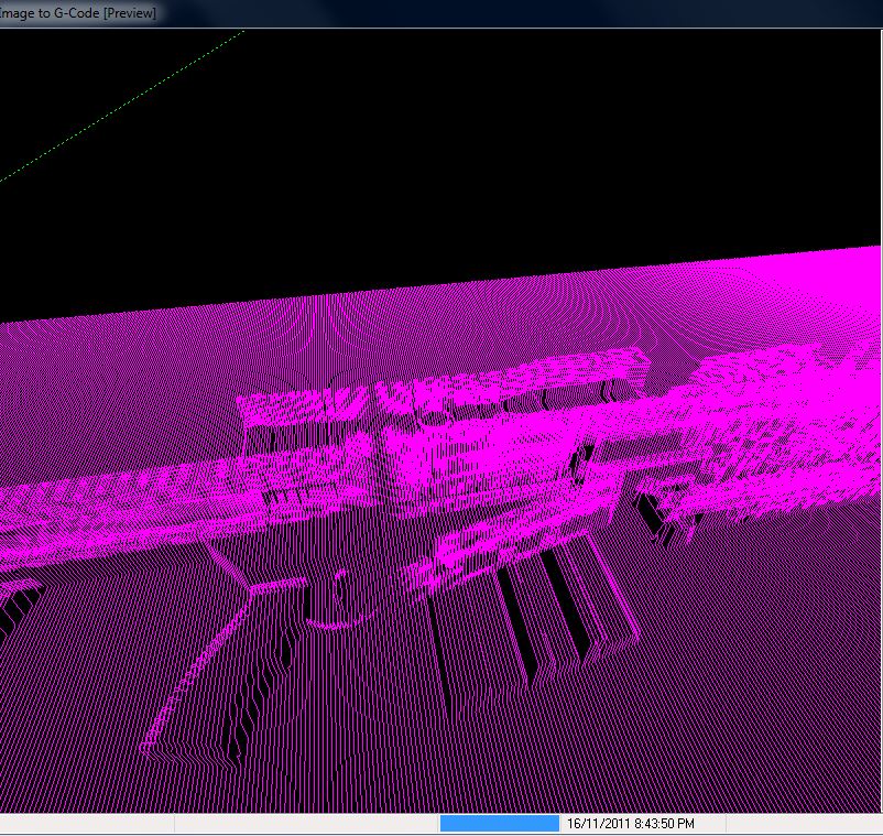

A simple example of why this topic applies to Spuds. Many of us dream of making the perfect "copy"; a BFG that actually looks like a BFG rather than a plumbers nightmare.What you could do with "proper" drawing software is difficult to fathom. Bravo.
So.........
Start with a suitable image
Apply a nifty program called Image to G Code
Feed the G Code to your CNC router
Load the router with some material like a sheet of HDPE 25mm 1200x600 that most of us have under the bench
Presto, out comes the grips, stock, receiver etc that we dreamed of.
19,000 lines of G-Code that look like this:
G90 G80 G40 M3
G92 X0 Y0 Z0
G01 F140
Z-1.000
Y6.24 Z-1.0
X0.02
Y0.0
X0.04
Y6.24
X0.06
Y0.0
X0.08
Y6.24
X0.1
Y0.0
X0.12
Y6.24
X0.14
Y0.0
X0.16
Y6.24
X0.18
Y3.37
Y3.36 Z-0.984
Y3.35 Z-0.961
Y3.34 Z-0.933
Picture examples herewith.
So.........
G90 G80 G40 M3
snip
If only it was that easy. What you describe is surfacing. Great for making Starbuck logos, small trinkets, visual appeal stuff. It would be great for making thermoform molds. For a "real" part, you gotta go CAD CAM for now. In a few years, that may change with manufacturing information embedded in drawings. For now, a 2 or 3D drawing to work from is hard to beat. All the current systems are geared that way. I am looking forward to drawing files JSR can e-mail to us for manufacture. (Finally):D
USGF
@USGF
Sorry, have to disagree.
Yes, I simplified it a bit, what I tend to do is feed the G-Code via CAM/BAM then into Mach 3 for the actual job.
This is exactly the technique I have used to produce actual 3D parts.
Not surfacing, the mill cuts all the way through apart from holding tabs. The thing to remember that you are making 2D sections that become 3D. To make a stock, I cut two mirror halves, each 50% of the final thickness required. Cut the mirror images, then laminate them for the finished result.
Cheers
Cheers
