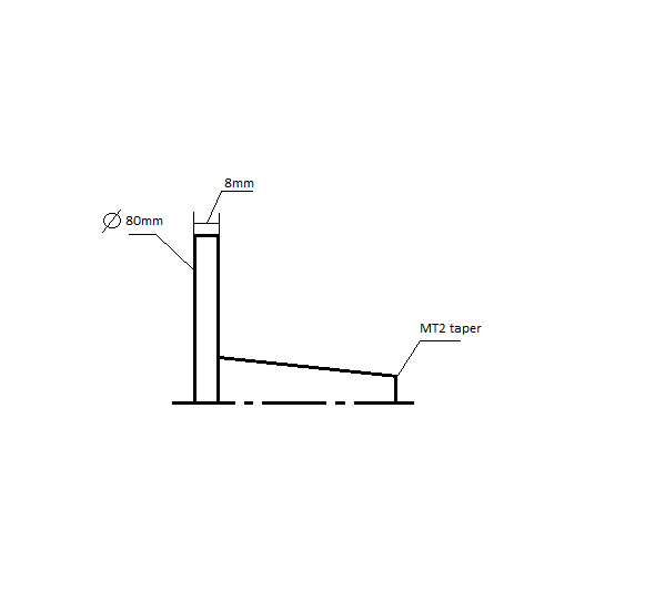

Need this part to be done, using stainless steel.
Fri Feb 21, 2014 5:40 pm
I can't cut SS but more info is needed. 1 piece or 2? If 2, how to join them? M2 taper just on the top side? How long do you want the taper? Is the taper piece flat or round? If flat, how wide? The piece perpendicular to the taper, how wide?
Are you supplying the SS? Or is the person making the part getting it for you? The more details the better my friend....You want the part to be right the 1st time so there will be no need to re-make it a 2nd time. :bigsmurf:

Preferentially in 1 piece, MT2 taper for MT2 lathe tail stock... LOL round of course, you should have got that by the axial line... I accept two piece also, if both of then have a female M10 threads so I can thread them with a M10 screw.
I'm not making this by myself because I don't have ss bar of such size, so who ever takes this job need to have it.

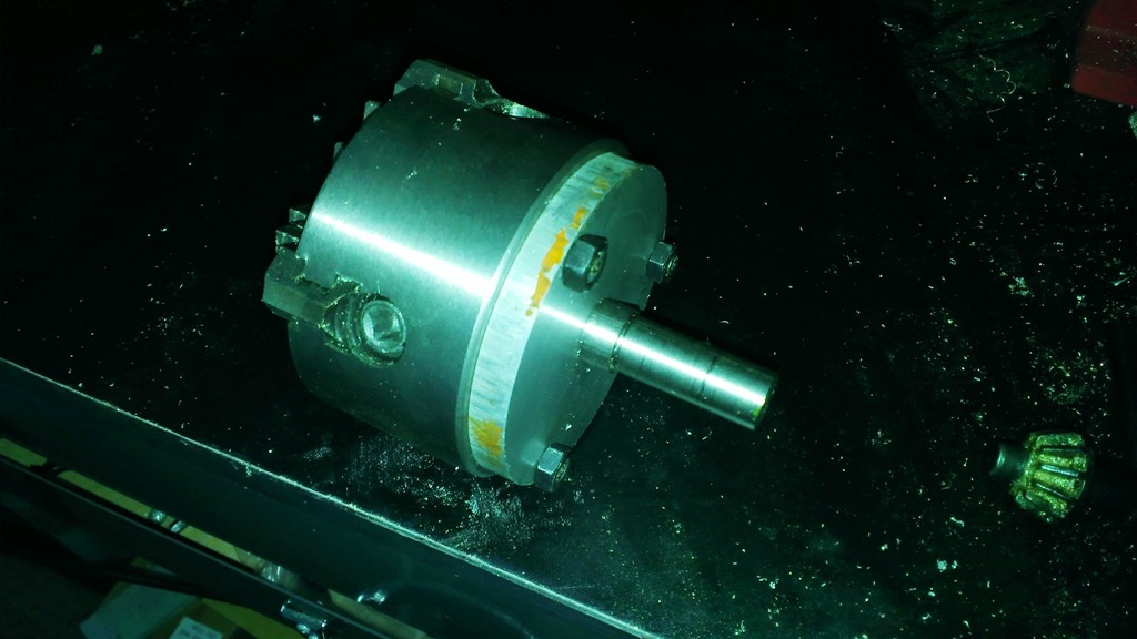

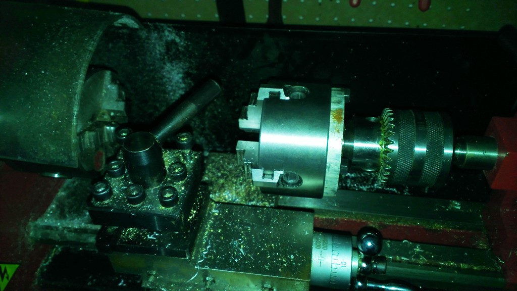

Thanks everyone for the input, anyway I managed to make it myself (perks of having machines, you can make your own tool)
Aluminium face plate (can't find same size in steel) and SS shank. Didn't have SS in hand big enough to make it MT2 taper, shame that I need the drill chuck to hold it, but it work so... :D
