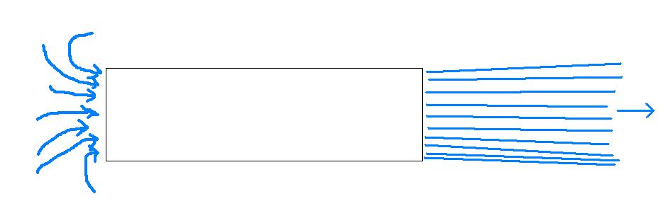

Yes, but think of this. If the sucking air was equal to the thrust, then it would be impossible to hover, because the exhaust pipes would need to face the same way as the intakes. Heres how I'm guessing it works.
With the outlets, most of the gas goes straight out the back of the engine, and very little blows sideways, because of the momentum of the air. On the intakes however, there is a vacuum pulling air from all directions, inculding the air to the side of the intake, which means very little thrust is generated.
Also, try this. Get a bendy straw, and bend it at a 90 degree angle. Put the long end in your mouth and blow. The straw will try and move sideways. However, if you suck on the straw no noticeable thrust is generated.
Here's a pic of what I think happens with an intake compared to an outlet.

Insomniac: You've got the basic idea but the difference in thrust is based on the difference in velocity of the two air flows.
The air intake is usually larger than the exhaust (but it doesn't have to be).
The air intake speed is slower than the exhaust speed, as a result the density of the intake and exhaust gases is different (exhaust has lower density).
The force created by the two thrusts are proportional to the square of the flow velocities. (Mass would normally be in the force equation as well but all the mass that enters the engine also exits so mass cancels. Well almost, there is a small amount of additional mass exiting because of the injected fuel but that is a very small percentage of the total mass.)
Result, it is possible to get net thrust even if the intake and exhaust are pointing in the same direction. (Of course, you get more thurst if the two vectors are working together instead of against each other.)

Yeah, but even blowing very gently generates more thrust than inhaling as hard as possible. And with aircraft props, intake and exaust are so close together its hard to tell the difference between which is making more thrust, because when you think about it, where on the prop blade is it counted as intake, and where is it counted as exhaust?
ok how about this. imagine a shop vac that can blow as well as suck. if you put the shop vac on the vacuum setting then you dont feel the hose being pulled foreward. but if you have the thing blow then you can feel the hose pushing back against your hands.
blowing creates more thrust than sucking.
