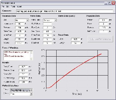

EDIT: i just did a GGDT test of a diablo .25 cal pellet traveling at 250 FPS (i did the calculations on my "predicted" gun). if the gun is elevated at a 1 degree angle, (easily acheved by adjusting my scope) i can get an accurate range of 135 feet out of it. the pellet hits its appogee at 60 feet, and hey, thats good enough for me.......

A piston would be overkill, just get yourself a QEV - even a 1/2" one will suffice. Make sure you can pump it to at least 200 psi, as you get smaller chamber pressure helps more than chamber volume. If you want accuracy, make sure you have a pump that can give you consistent pressure.
Have a look at what GGDT has to say, you can easily get at least double the power of his gunplus, it makes him cringe when i say im building myself a .25 cal airgun...... ecven if its got half the power his .177 cal rifle has...
