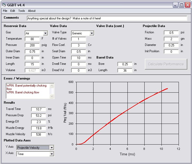

im not really looking for high power, just something i can "hit those cans" down with effectively. i did find a peice of tubing on mcmaster that was .251 inches ID, thus the right size to fit .25 cal diablo pellets. i dont know if im gonna get AWSOME accuracy out of this thing, but whatever, it will be cool. i might even be able to rifle the peice of tubing myself....
anyway, thanks for all your help, youll see this little bugger out here sometime. im thinking of making it piston-valve actuated int he over/under fasion. the chamber will be 3/4 inch galvanized steel, the piston a 1/4 inch brass tee, and of course, the .25 cal barrel. ill slap all this onto a nice homade wodden stock, a blowgun, and wala! pellet gun. might not get the 500-1000 FPS power my friends pellet gun gets, but hey, i can sure have some fun plinking.
plus, it makes him cringe when i say im building myself a .25 cal airgun...... ecven if its got halph the power his .177 cal rifle has...
EDIT: i just did a GGDT test of a diablo .25 cal pellet traveling at 250 FPS (i did the calculations on my "predicted" gun). if the gun is elevated at a 1 degree angle, (easily acheved by adjusting my scope) i can get an accurate range of 135 feet out of it. the pellet hits its appogee at 60 feet, and hey, thats good enough for me.......
A piston would be overkill, just get yourself a QEV - even a 1/2" one will suffice. Make sure you can pump it to at least 200 psi, as you get smaller chamber pressure helps more than chamber volume. If you want accuracy, make sure you have a pump that can give you consistent pressure.
Have a look at what GGDT has to say, you can easily get at least double the power of his gunplus, it makes him cringe when i say im building myself a .25 cal airgun...... ecven if its got half the power his .177 cal rifle has...

for jackssmirkingrevenge: the longest barrel i can get is 28 inches long.... but i did have a heavier pellet wieght on my test, i also didnt do the valve thing right.... i realized i had the piston like at a weight of 500 pounds........
also, i have a bike pump that will hit 300 PSI....
and i guess your right, a 1/2 inch QEV will work much better than any mimi-piston valve i can create. plus, its easy as pie, and pretty cheap.
