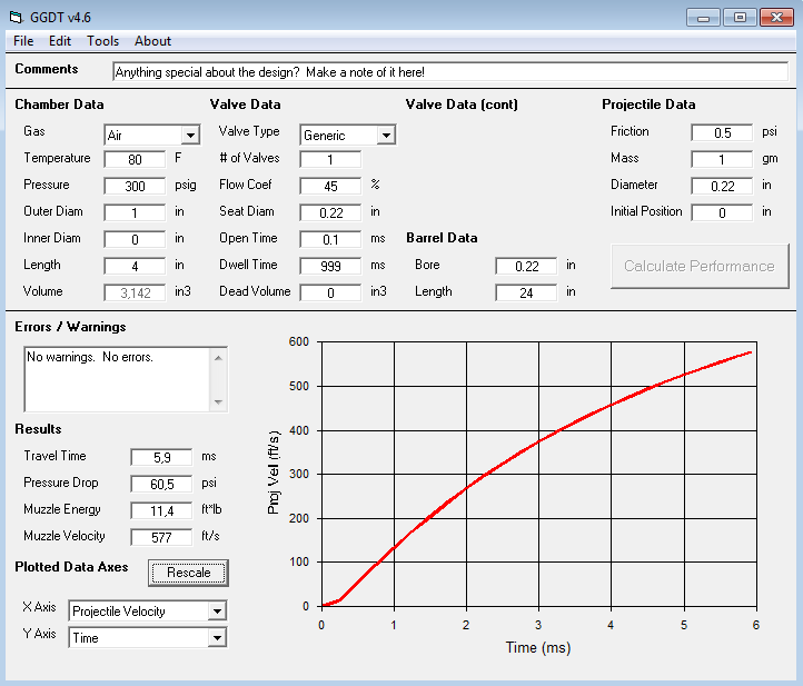

GGDT suggests that at just 300 psi with a fast efficient valve and a 4" by 1" chamber and 24" barrel you could rival the performance of a UK legal 0.22" PCP, though it would be a one-shot affair.

I'll have to play with ggdt some, 500fps isn't bad but it doesn't quite rival some commercial pcps and springers.

Juggernaut12121 wrote:I'll have to play with ggdt some, 500fps isn't bad but it doesn't quite rival some commercial pcps and springers.
Unless you can access higher pressures, this is what you'll be limited to.

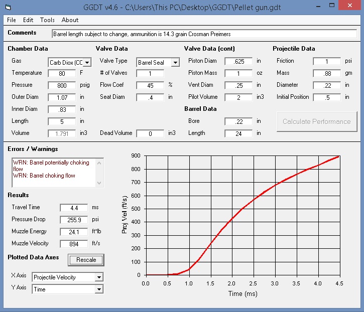

I was going to make my own QEV to handle higher pressures, along with this I plan to operate it off of a 20 oz CO2 cylinder (I've got at least three lying around along with an ASA fill adapter, to adapt the threads over to 1/8'' NPT). As I've said I've went about comparing the two valve models on GGDT and it seems that a QEV rifle will rival a hammer valve pretty well. So far my current configuration yields results of almost 900 fps (I want to get a high velocity for power but still stay under the sound barrier so that the pellets won't destabilize after being fired).
Some GGDT specs
Some GGDT specs
Extending the chamber to 6" knocks the velocity past that 900 fps mark :lol: , which rivals the closest PCP rifle (Benjamin Discovery). Although I'm unsure of how long my CO2 tank will last (I realize there's probably a pretty simple way of figuring this out, but I haven't done this yet).

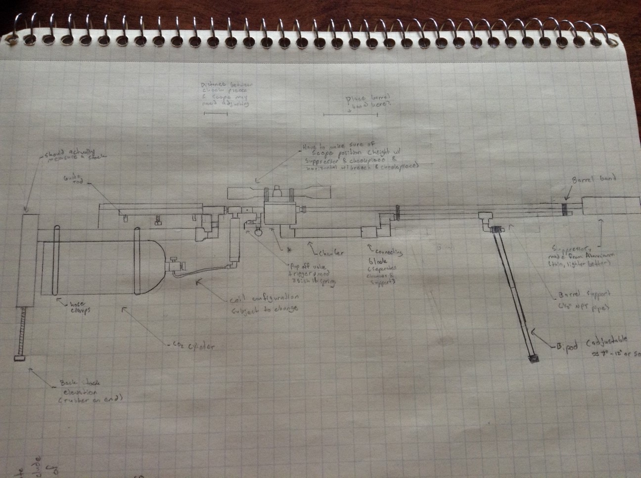

If it helps, I could upload some of my drawings to show where I'm at right now as far as design goes. Thanks for all the feedback :)

Reality check time.
If you get 900 fps on co2, you'll be the first to do so. Some have claimed 800fps, but their claims remain unsubstantiated as far as I know. Have done mid 700's so figure the 800 claims are at least possible.
Pellets do not destabilize by shooting them through the sound barrier. They destabilize when they pass BACK through the sound barrier....keep them fast all the way to target and they WILL group. Have seen it on a Condor shooting .177 @ 1400fps.

Drawings and diagrams are always helpful to convey an idea...if you have them, post them. Can't hurt and might help.

I don't know how much it will help but here's a cruddy drawing.
The chamber, barrel support, and parts of the stock and handle are made from iron plumbing fittings, the QEV will be machined from a steel block to handle the pressure.

Have you considered using a slide check in place of the relief valve trigger? Will shut the flow off from the supply while venting the qev at the same time. Just a thought. :)
If you've not purchased your coil line etc yet, can get one with a slide check so you don't have to buy it separately.
