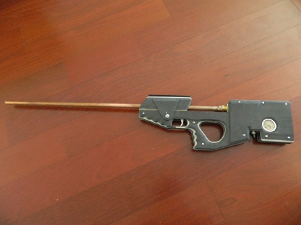

I want to share my finished project with you all so I can get some feedback and to offer my creative contribution.

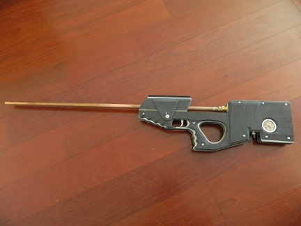

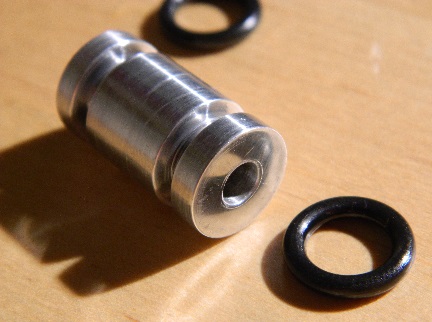

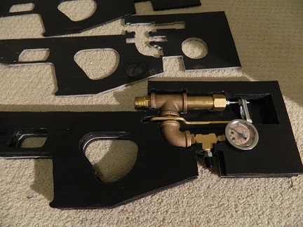

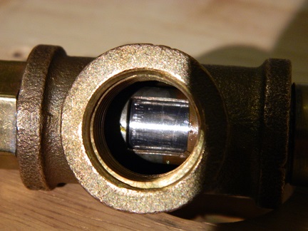

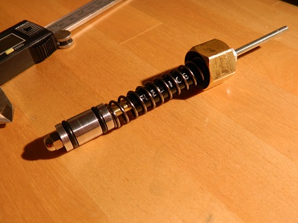

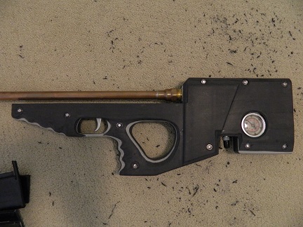

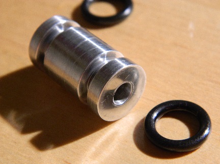

At the heart of the gun is a scaled down Quick Dump Valve (QDV) which is Technician1002's design. Thank you! I chose this route because I wanted something simple and mechanically actuated.
Here are the basic specs:
Barrel: 1/2" Type L copper tubing and 32" long (smooth) UPDATE: Changed to rifled barrel (see below)
Chamber: 1/2" threaded brass fitings
Valve: QDV
Working Pressure: 800-850 psi
Operation: Single shot
This gun was primarily made with just hand tools. I did use a electric hand drill too, soldering iron, and blow torch. I machined the piston by chucking it into the hand drill and clamping the drill down to a table on its side and taking a file to it.

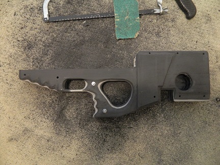

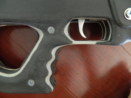

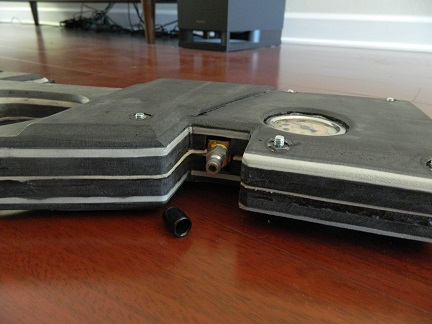

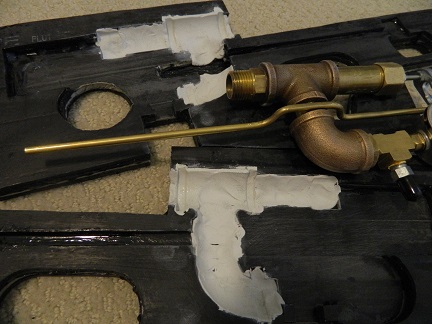

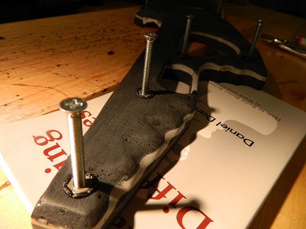

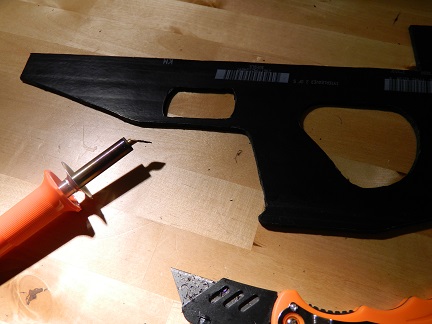

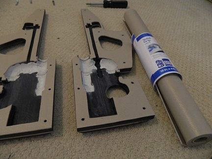

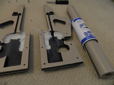

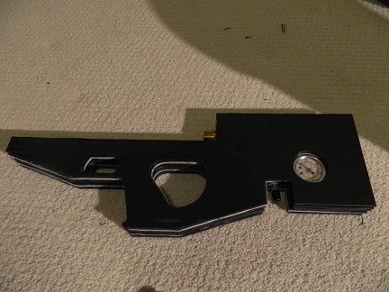

I think the only innovative design aspect of the gun is the stock I made for it. It's a clamshell! It's made out of flattened and laminated ABS DWV pipe. I cut the shapes out using a soldering iron with knife attachment. I joined the layers using ABS cement. And I devoted long hours to sawing, carving, and sanding it for ergonomics. There is an upper and lower receiver which are easily joined/separated with a single bolt and wingnut. I really enjoyed working with ABS because you can weld it, melt it, glue it, cut it, drill it, bend it, impress it, and even mold it too. You have to be careful about what you breathe so I invested in a respirator with a charcoal filter. This was handy for using the soldering iron on the plastic!

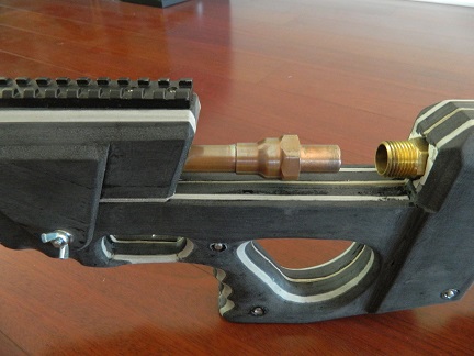

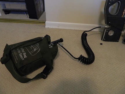

Right now I have a 3000 psi 47 cubic inch aluminum paintball tank and remote hose to hook up to the gun via fill nipple. The regulator brings the pressure down to ~850psi. To load, I unscrew the copper barrel from the brass nipple, slide forward, insert ammo, slide back, and screw it back in. There is no safety feature built in yet. And pull the trigger. The gauge in the stock goes from 0-1000psi for an indication of the pressure output from the source.
I've only been able to dry fire it in my storage room with a bag of clothes as a silencer and it still makes quite a loud *THUD*. When I get a chance to fire it outside with ammo I'll try to take a video.

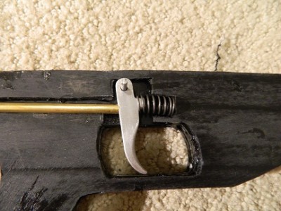

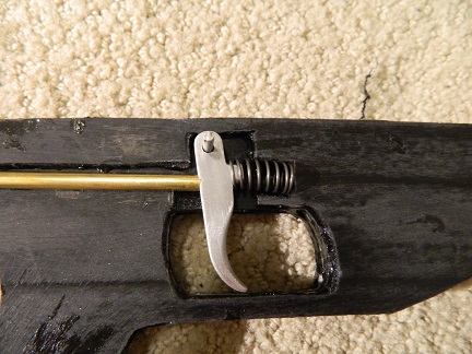

But here's the trigger mechanism first >>> [youtube][/youtube]

Very good job! I can tell you did indeed spend a lot of time on that stock, and component placement/etc. was very thought out.

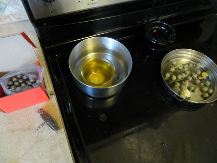

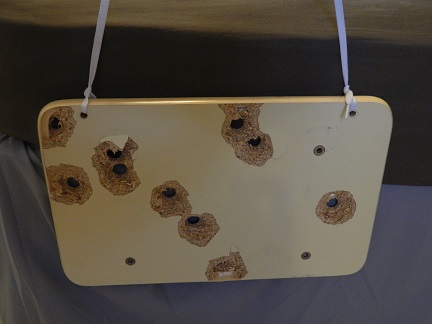

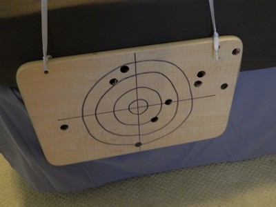

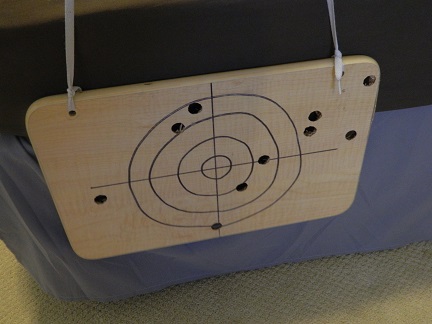

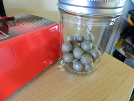

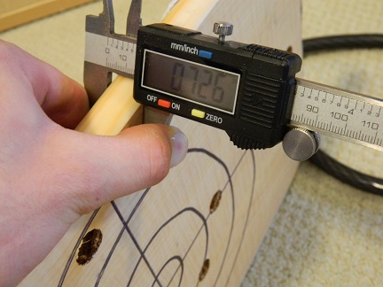

Update! Today I went into the woods to shoot at a 3/4" thick particle board target measuring 10" X 16". I used my scope and attempted to zero it out at 75ft. After getting it somewhat narrowed down I could hit the board every time. But I noticed the balls were curving too. So I need to design better ammo. To get around using wadding I dipped my balls in some wax to make up the slop in the barrel. This probably is what caused the balls to curve. As for amount of shots, I started out with 3000psi in the tank and after 20 shots I was only down to 2000psi (remember the gun runs off 800psi) See pictures! >>>

I love the stock!
I like the trigger linkage too.

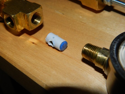

I realize there are a few QDV diagrams around and I have read about them, but most seem to be larger calibre. If you have time could you please explain in simple teerms how your QDV is constructed, functions as would love to be able to replicate it if you don't mind, please bear in mind I am new to building valves, so keep it simple for me

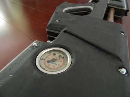

Ps what is the little gray/blue part with the hole through it?

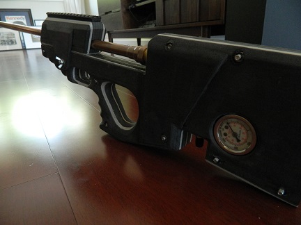

Ianbuckwell wrote:Ps what is the little gray/blue part with the hole through it?
auxiliary wrote:I used a bic pen to restrict airflow to the gauge to prevent damage caused by sudden pressure loss upon firing. The hole is so small that the gauge goes down 100psi per second after firing.

Ok, thanks sorry I missed the description under photo. I really love the design/style of the gun, especially the stock, really finishes it off giving it a professional manufactured look, but at the same time better as it is unique, I hope you are proud of it, I know if I could make something that smart I would have a big grin everytime I looked at it, this is one of my favorite guns on spudfiles and any other homemade guns I have seen, Well done its superb!

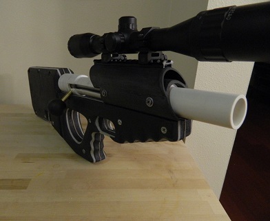

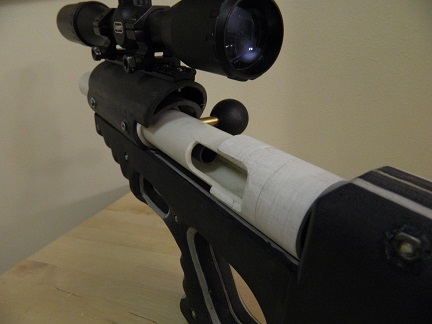

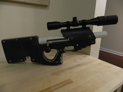

So I made some changes to the gun... I received in the mail my 10.5" long 1 in 12" twist rifled long Colt barrel. Got it here: http://www.ebay.com/itm/45-Caliber-Rifl ... 1628797451 I made a bolt action mechanism using 1" PVC pipe. I created a new upper receiver to mount the scope.
I made a video that you may be interested in watching. It should answer some of your questions. Plus I do target practice!

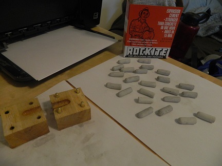

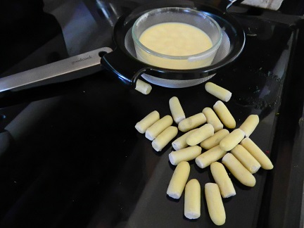

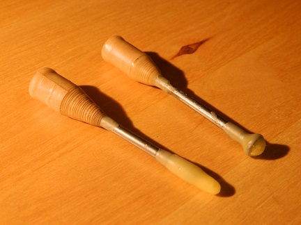

I little description of my ammo... For the cement bullets I used "Rocktite", this stuff with a creepy picture of a man. It's a mixture of gypsum and Portland cement. I cast them using a wooden mold I made. The wax I used for dipping is beeswax. As for the darts, I used that paper packing tape that's like masking tape, but stronger. I think that shooting these off in the woods won't have as much an impact on my environment as lead would.

Since moving to a 10.5" barrel rather than the longer copper one have you seen a noticeable decrease in power? Or is your valve so fast it makes little difference?
I think my shots in the woods yesterday were less powerful because the ammo I was using wasn't precise like the .535 cal round balls I was using before. But even if I did have nice lead bullets for it (which will happen soon so stay tuned), I would expect less projectile energy because there is less area for the pressure to push on the projectile and less distance for it to push it. Work is force X distance. I will be trading energy for accuracy basically.
