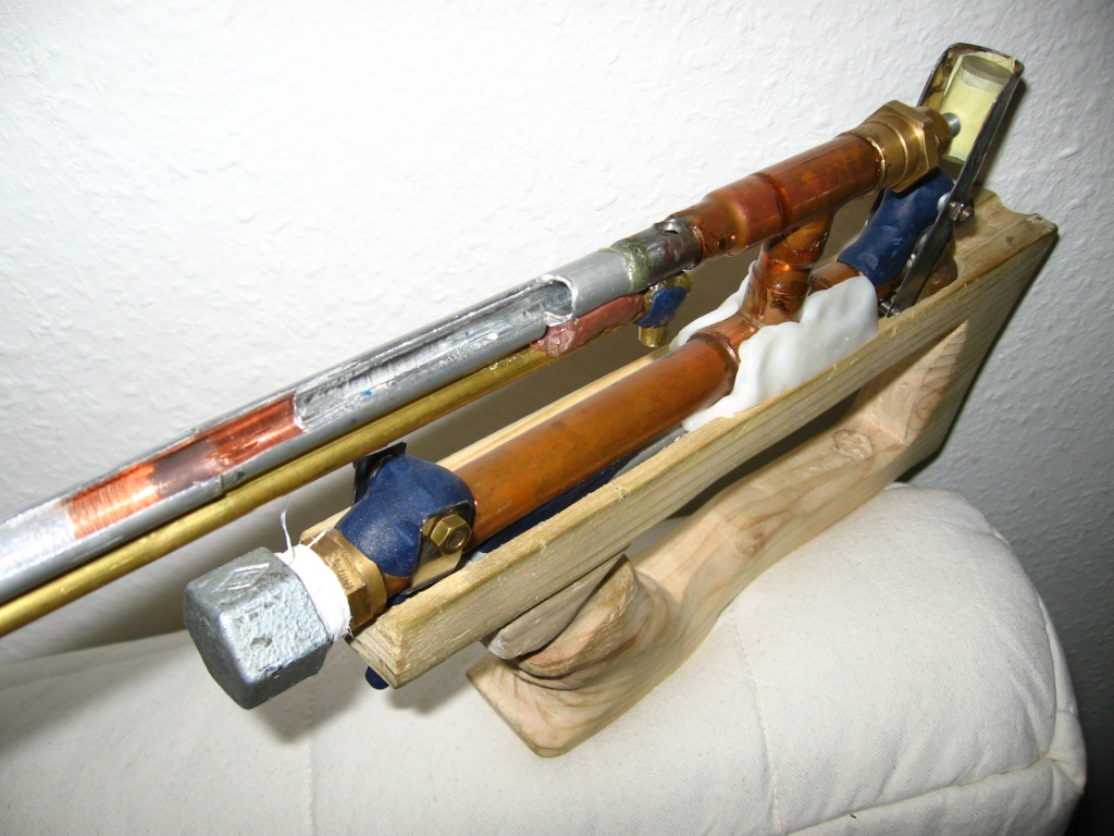

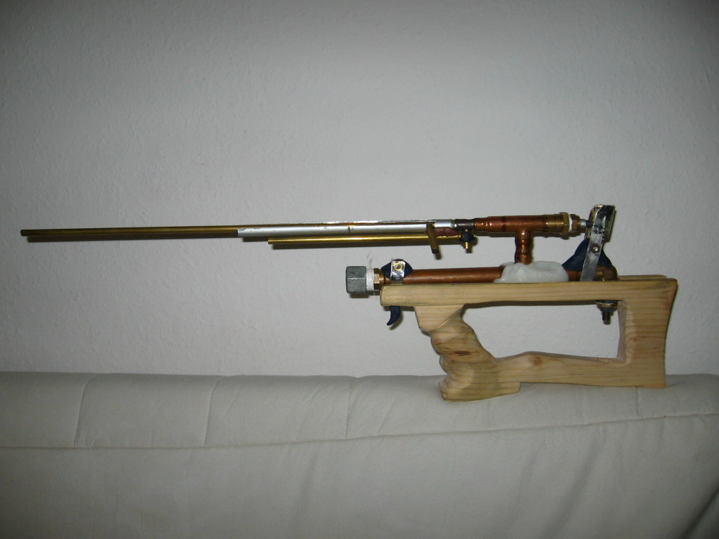

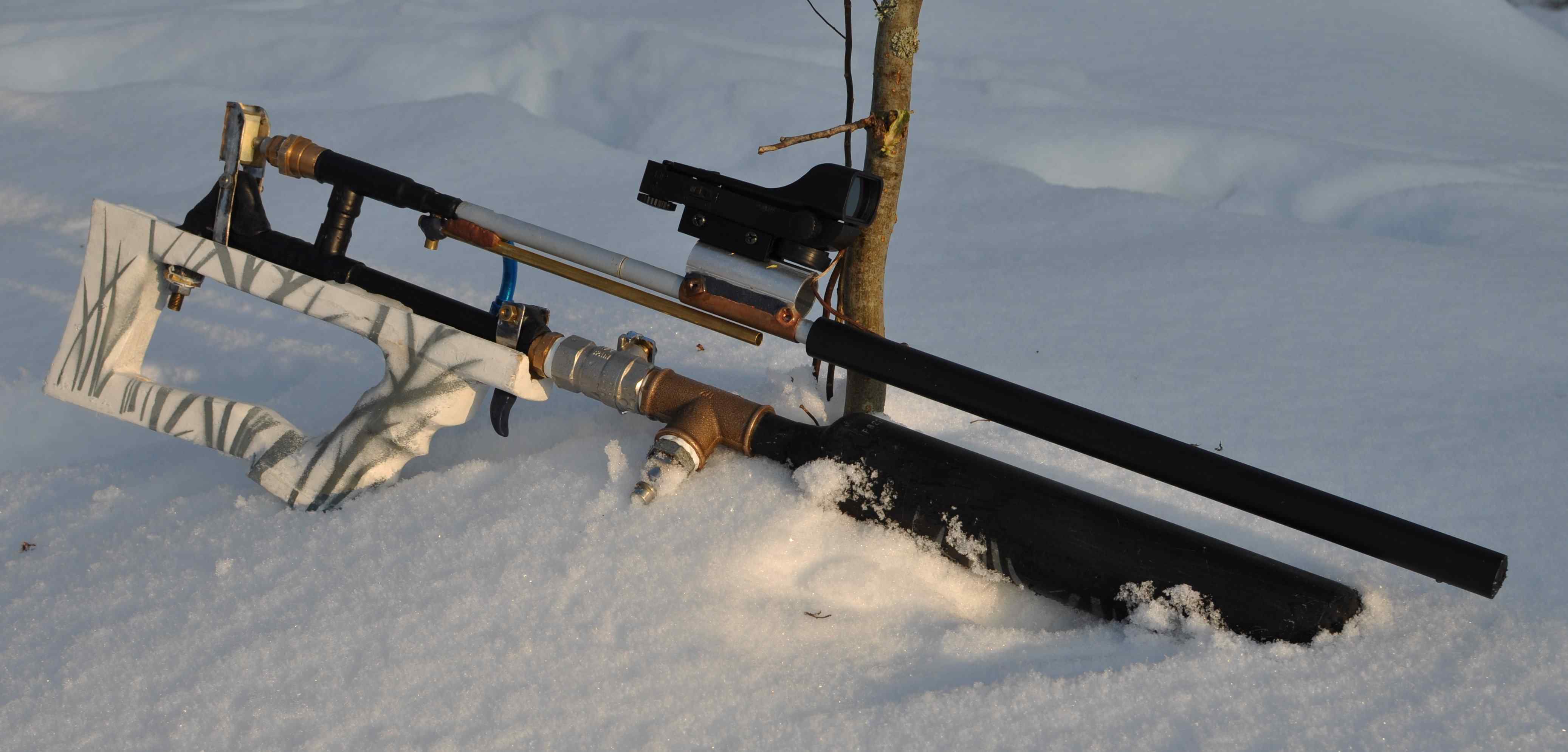

Long story short, I build a few guns and this is the first one, I felt like it was worth sharing it with you, although it's not totally finished.
I had a few basic points in mind, which I tried to achieve with this design:
1. the best performance/efficiency I can get out of it.
2. compactness or/and the possibility to be disassembeld
3. multishot capability
4. interchangeable barrels
5. magazin for 6mm steelballs but also the ability to load darts etc.
For point 1. I deicded to make a homemade pushbutton pilot for smallest pilot volume (and better flow than blowguns, etc) and a breech where
the projetile is just millimeters from the sealing-face of the piston

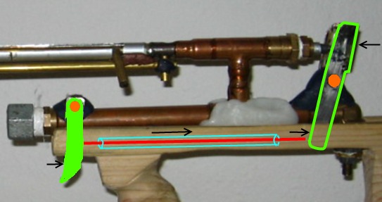

For point 2. I chose it to become a bullpup with a trigger design, where a long rod pushes the pilot. For easy piloting, I also took care of a
certain amount of leverage at the trigger and also at the second lever in th rear of the gun

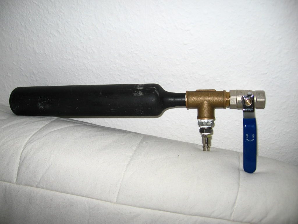

For point 3. I got a soda-stream bottle, where I removed the checkvalve, as the main-chamber, that feeds into the firing chamber,
via a ballvalve to adjust flow.
But the biggest mess was to achieve point 4, because it really was a PITA to cut threads into thinwalled copper or aluminium pipes
(only things available for me). So I had to epox them together before cutting threads, what failed several times, but finally I got it to work fine.
That is also the reason why i looks a bit awkward at the breech (consisting of several pieces of pipe glued together...) and I got some
serious leaking problems after finishing it, at the breech and/or the valve. At first the leakage was almost ignorable, but increased with the time,
so I finally decided to "pour" (with the help of a thin brush) epoxy in to it, from both sides of the valve, and let it rinse out of the barrel.
That worked rather fine against leakage, but now the piston wasn't fitting anymore, so I sanded the housing of it, and made a new piston.
After building the Stock and trigger-mechanism, I recognized the chamber being far to big for multiple shots, but I couldn't cut it down anymore, so I just
put a hot glue-stick (with a screw at the end to avoid it choking flow) into it, to reduce the volume,
(which could always be pulled out for higher performance shots)
What was also veeery fiddly, was the mag. I always got it to feed multiple rounds, and couldn't solve that by adding whatever detent I tried.
The problem is that it is feeding into the outer-barrel which has a inner diameter of 8mm.
Finally I added a vertical bolt pushing up a single round everytime, that has to be reseted manually every time, but I am not very lucky with this solution.
Besides I still have to sand that part internally again, epoxy find its way also to this place, and the rounds have a very tight fit, but I can't just drill
into it in the current (not anymore changeable) position, hmmm...
...ah yes, you might also notice that the copper fittings are epoxed instead of soldered together, what may be of special interest for someone...
Of course I have an outer barrel for this inner barrel, that is screwed into the threaded copper piece in the barrel-mount, but I don't have it here, i will post pics of it later.
Currently I'm working on a mount for the (cheap) scope I have, that will still allow barrel-changing.
Furthermore I want to build a triggerguard, bipod and a supressor for it.

And what a way to enter the forum. Very nice. You might want to put a couple clear coats on your grip. Pine won't show hand gunk very well. I always coat my grips in some way.
Kudos on the homemade pushbutton. And double kudos for working it into a trigger. This is a very great start, and I hope to see more from you.
Future improvements I can see? I realize the chamber must act as a horizontal foregrip, but maybe continue the wood theme elsewhere on the gun, perhaps between the chamber and the gun. This will act as a support, further stabilizing the structure, as well as make it look more whole.

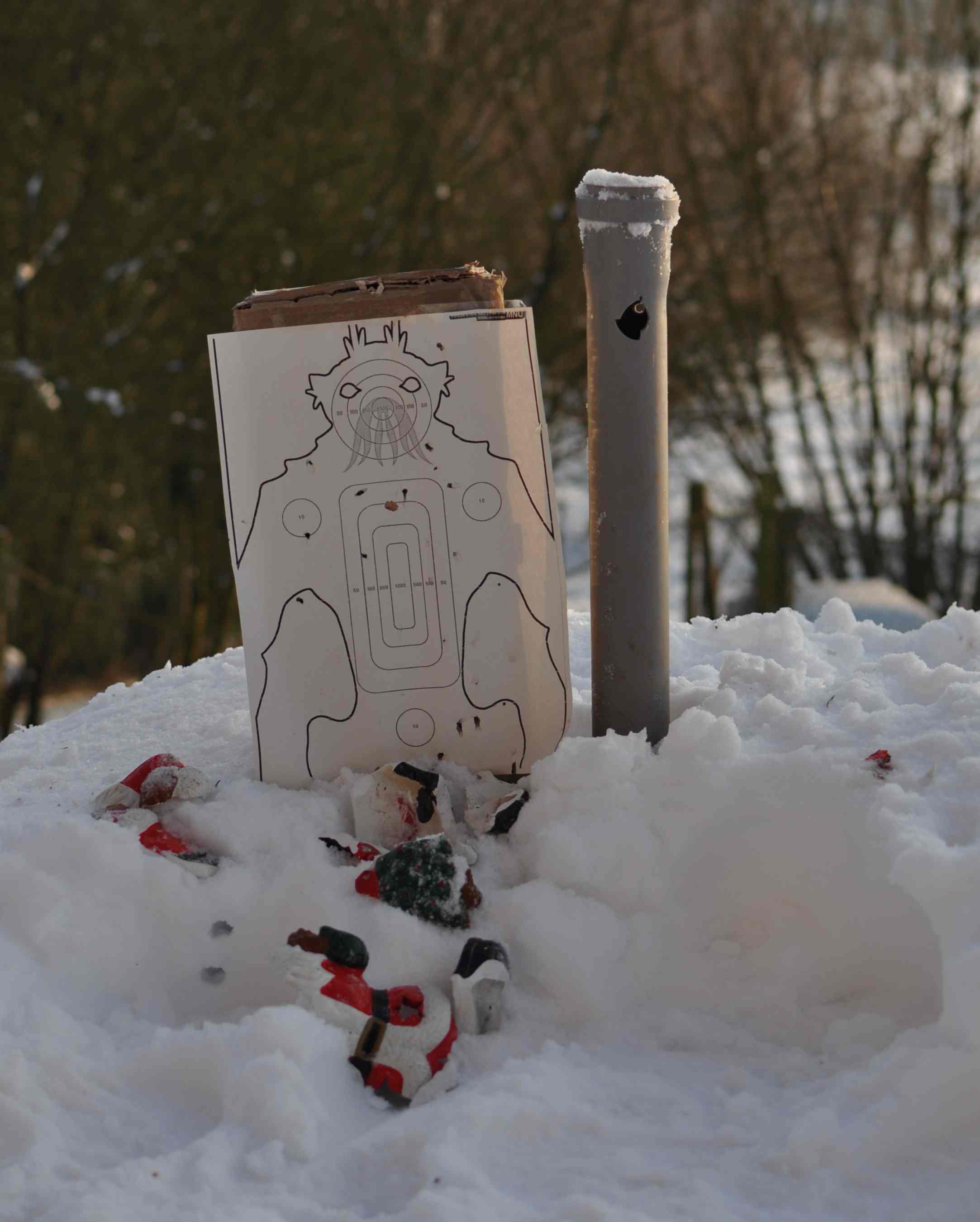

Currently I'm filling with either a bicycle floor pump, or small shock pump, what means pressure can be 40 bar max from the shock pump (this one), but I tested it only up to about 25, but for the reason I can only shot indoors currently, I am satisfied with about 8 bar most of the time.
I also got a fridge compressor, actually I got 4 of them, but 2 are broken , and one has a horrible low flow, although it is out of really large freezer
(anyone knows a reason why, or wheter this is fixable??? Someone from poland?
The compressor I am using now puts out 40 bar easily, but I am still looking for a good, long, affordable pressure hose, can't find a hydraulik one with non-metrical threads here...
And the performance is good enough for me (don't have anything to compare). With a longer barrel I shot a short steel bolt trough my old (sheet metal) computer casing with 12 bar or so.
Will post pics of that, when I visit my parents again, where I can also shoot outdoors, they live in a very rural area, instead of where I live, in the middle of a city.

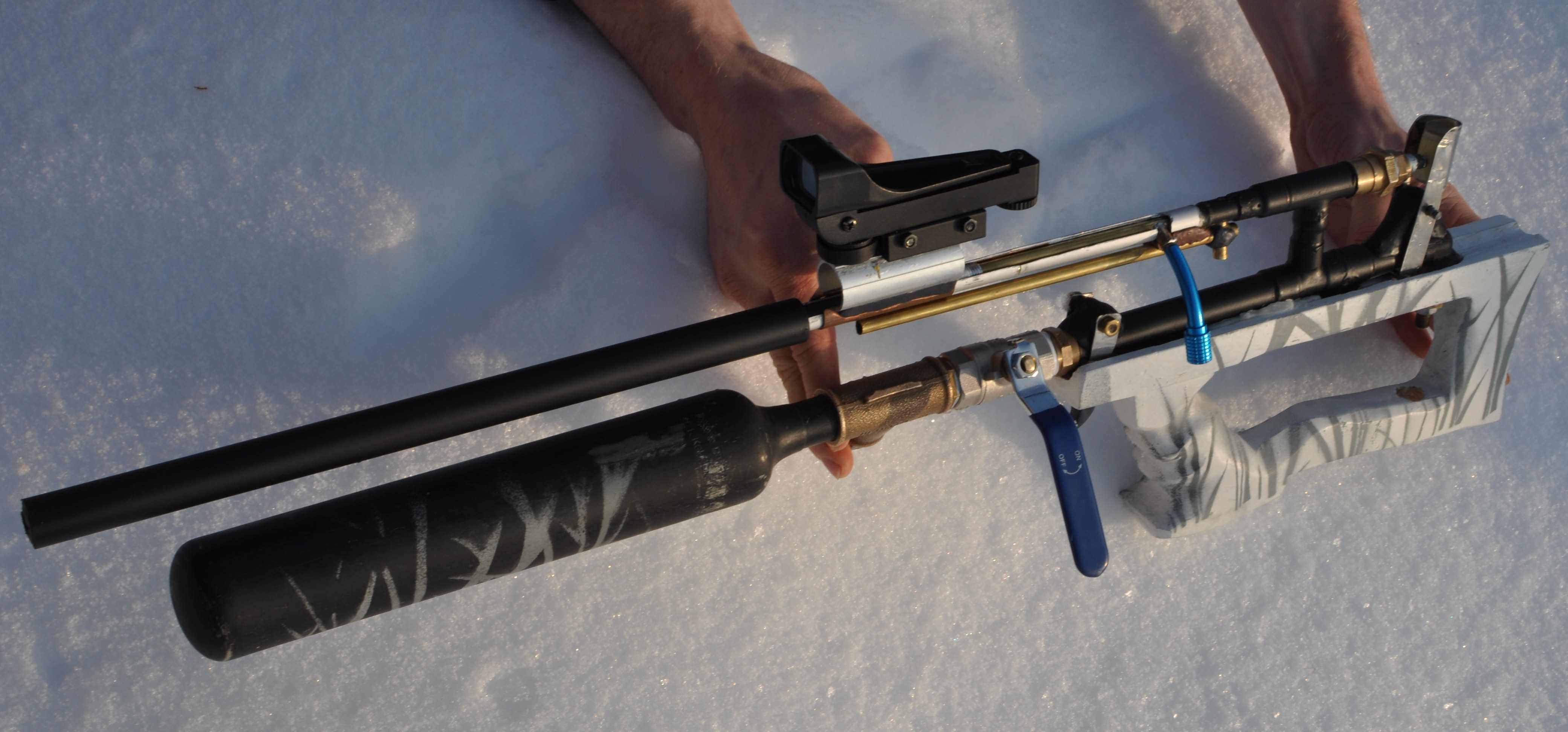

Had some time over Christmas at my parents, which I used for:
-building a detachable suppressor
-building a mount for a reddot/scope
-adding detachable handle to the breech
...aaand PAINT JOOOB!
How do you like it? At first I had it just flat white and black, as proposed before, but I didn't really liked it, so I spend an entire day deciding how to pimp the white stock up...
This is what I came up with!
(last three new pics in the first post)

Fantastic job on the paint. I really like how you continued the theme on the bottle.
It looks like you added a barrel shroud. Any thoughts on making that into a functional silencer?
The only things I would add to this are a trigger guard and a continuation of the wooden grip theme, but thats just me. Darn artist's brain.

I get about 5 acceptable hard shots, and after that about 6-9 shots, that are too weak for my taste. I would really like to add a regulator to the gun, but the one I got is made of plastic and i don't trust it over 20 bar (rated to 16).Lockednloaded wrote:do you get multiple shots per fill?
If I find the time I will build one for high pressure, but I will need a lathe for the stepped piston I'm afraid...
@Gaderelguitarist:
The shroud actually already is a functional silencer.
It has one big chamber in the rear and 4 smaller ones in the front of it, separated with polymorph-discs.
The triggerguard is in work, it will be of aluminum...
And the wood thing is a good idea, but I dont know how to add it to the existing stock, without it looking just... "attached somewhere" if you know what I mean...

And second, I don't really understand the trigger mechanism, could you maybe post a diagram of it?

The Soda bottles I got have inner (female) and outer (male) threads.
I removed the checkvalve out of the inner threads (what was not that easy...), these were metric fine threads.
The outer (male) was 3/4, so I could use it.
But I had to use a lot of ptfe tape, because the connection was more "loose" than normally.
What bottles have you got? There are several different types and the ones I got are also older ones, which are not anymore sold/refilled everywhere.
Would you mind posting pics of yours?
Here is a quick made diagram of the trigger mechanism.
The (red) rod is free to move in a tube (turquoise) which is fixed/glued to the chamber pipe. The orange dots mark the position of the joints.
Got it?
I know that posting pictures of the gun with the stock removed would clarify that a lot, but I dont have it here and the stock is already glued.
Got it?
- trigger mech.jpg (35.48 KiB) Viewed 13109 times
