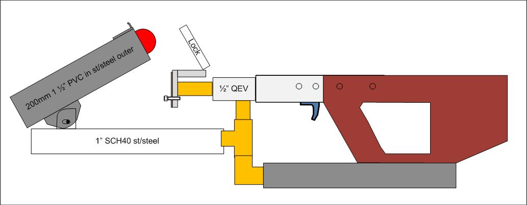

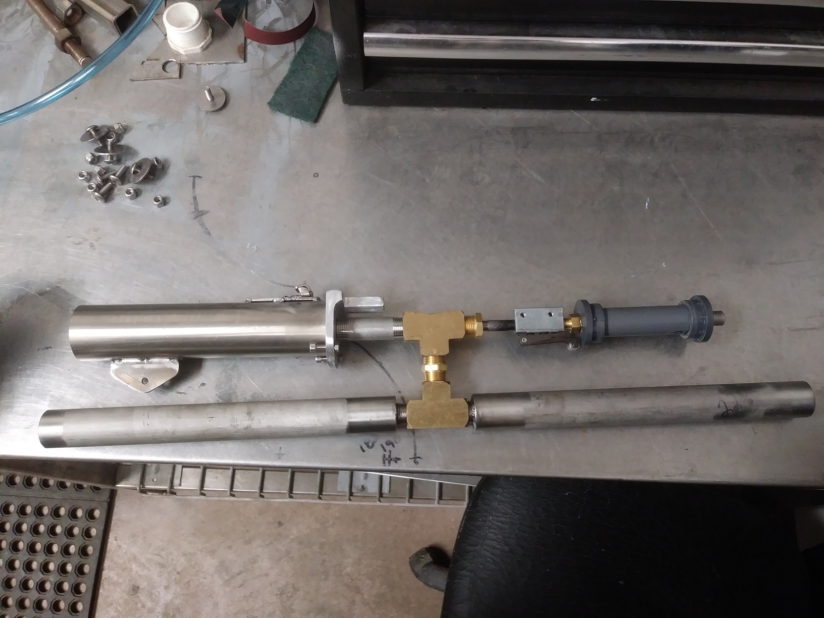

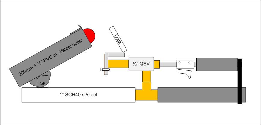

Starting a post for my 40mm lancher, planned ammo is foam balls (practice golf balls) Got a few parts assembled, waiting for a 1/2" QEV off Ebay.
Just going for straight layout to prove it works

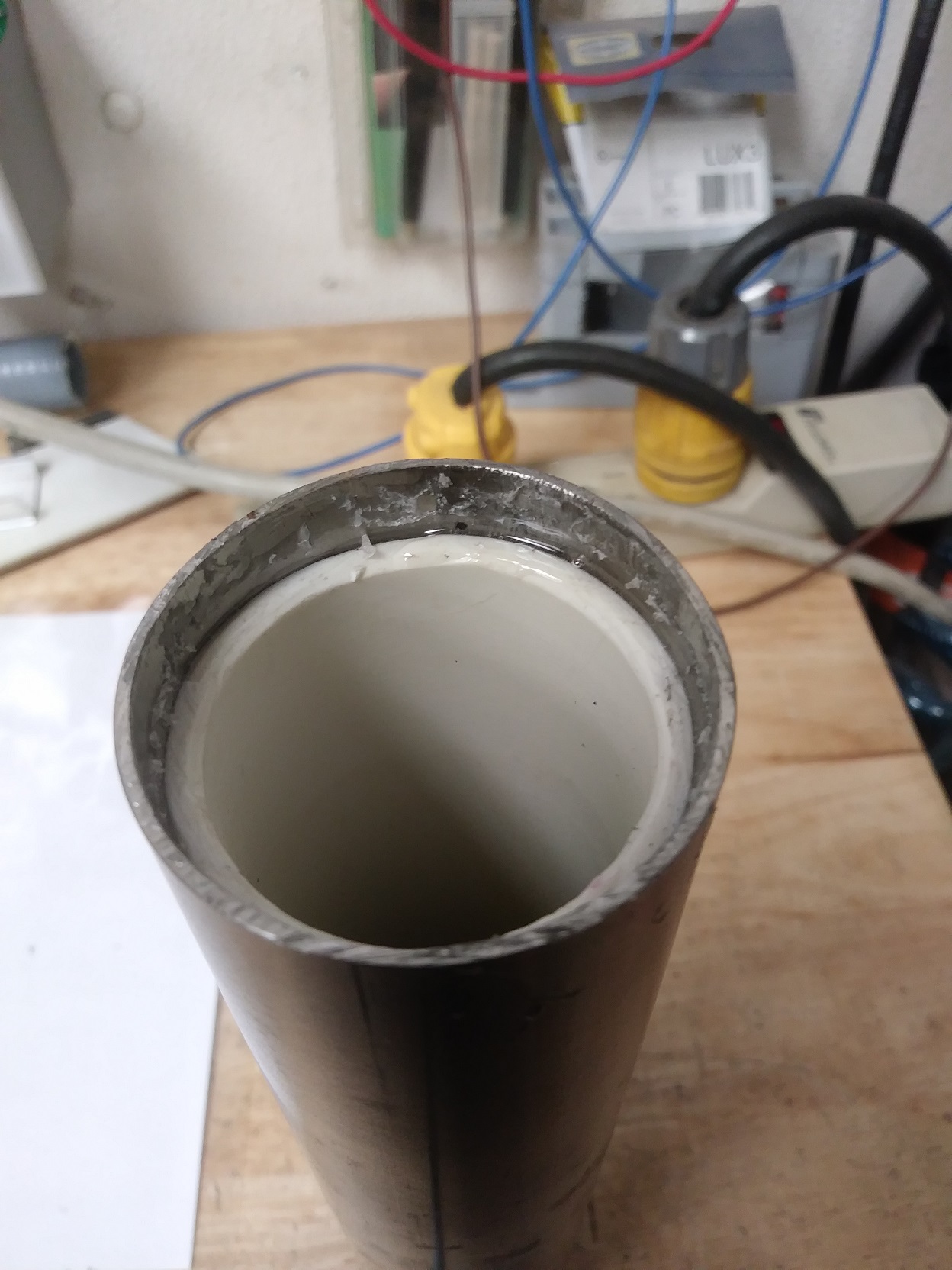

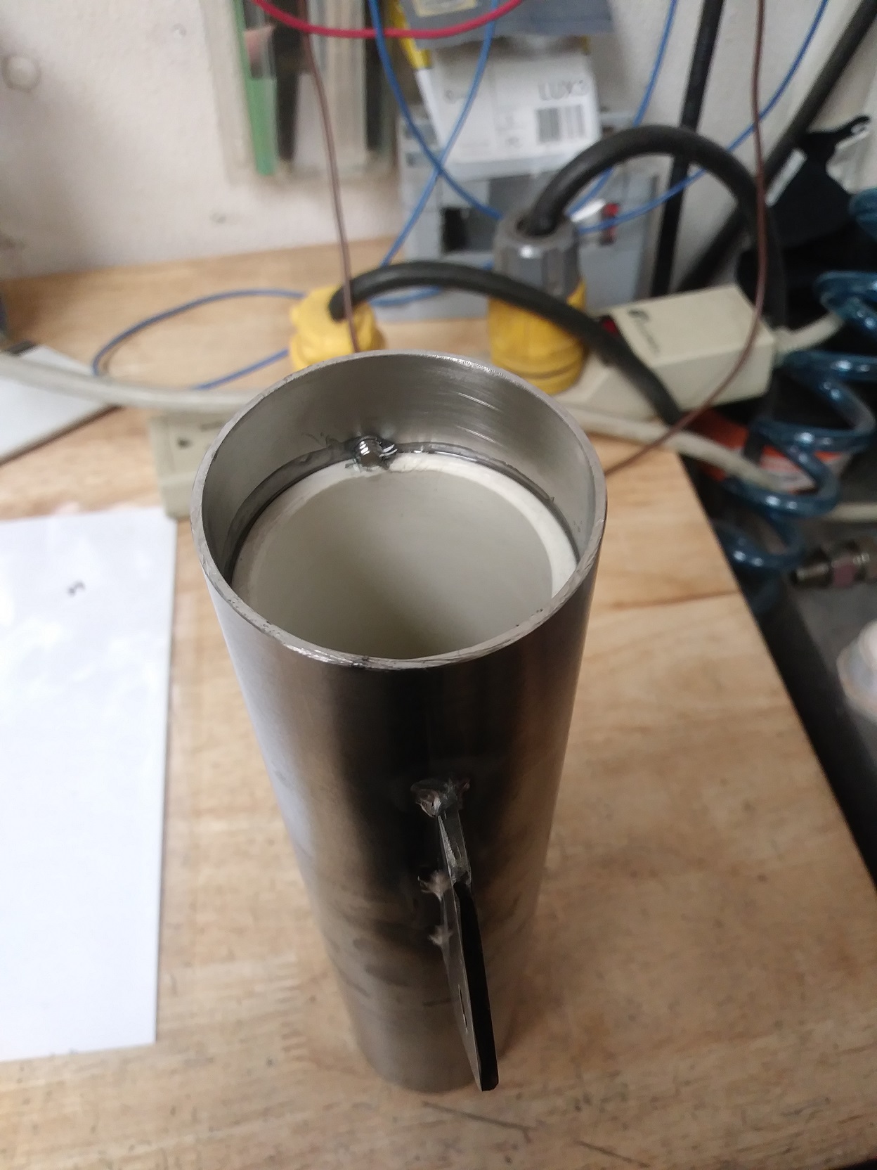

PVC pressed in with a bit of epoxy as well and a M4 screw as a stop.

A new layout that will allow for a stock :idea: dropped the second chamber. Need the QEV to get final measurements. :?
Main 3.jpg (32.33 KiB) Viewed 9264 times

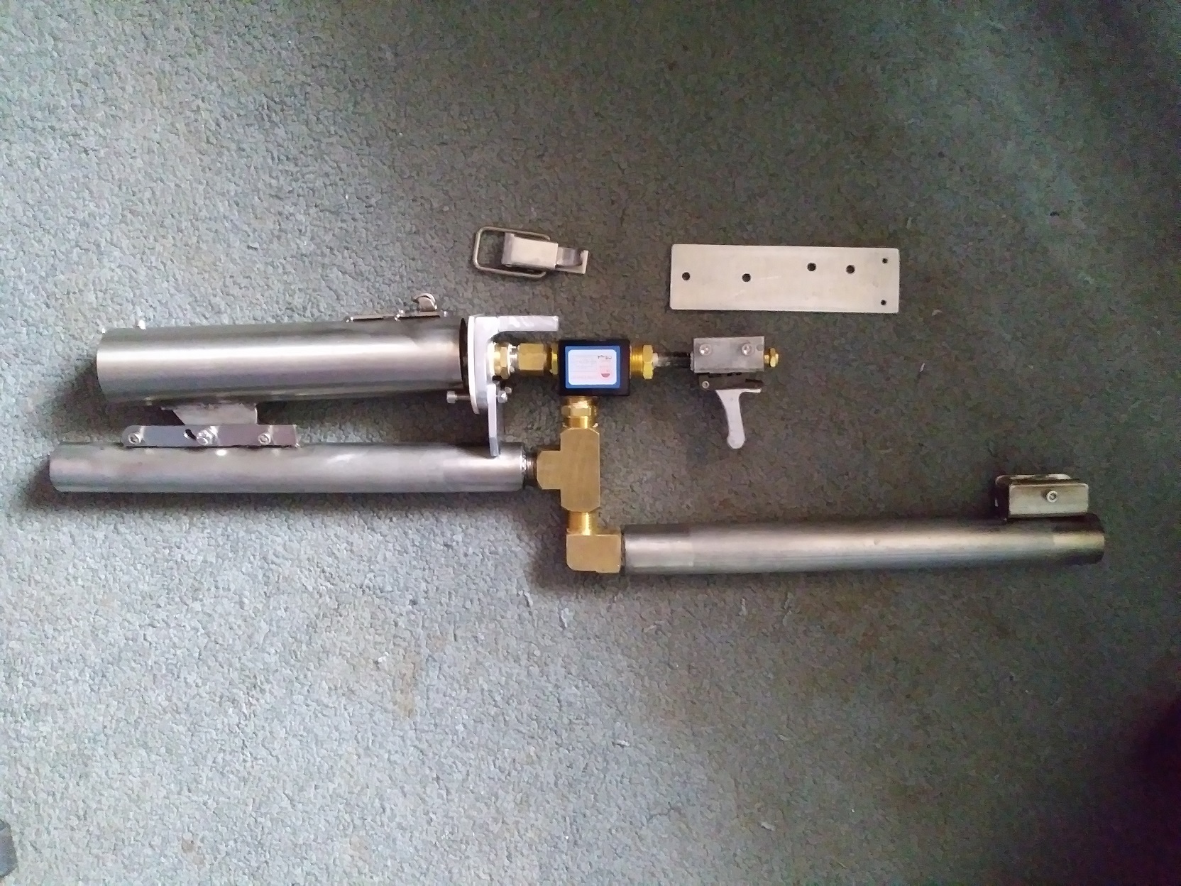

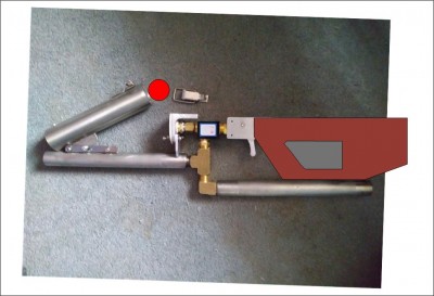

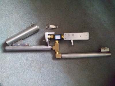

Main components finished ready for assembly, stock/grip made from 3/4" plywood will attach to brackets.

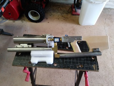

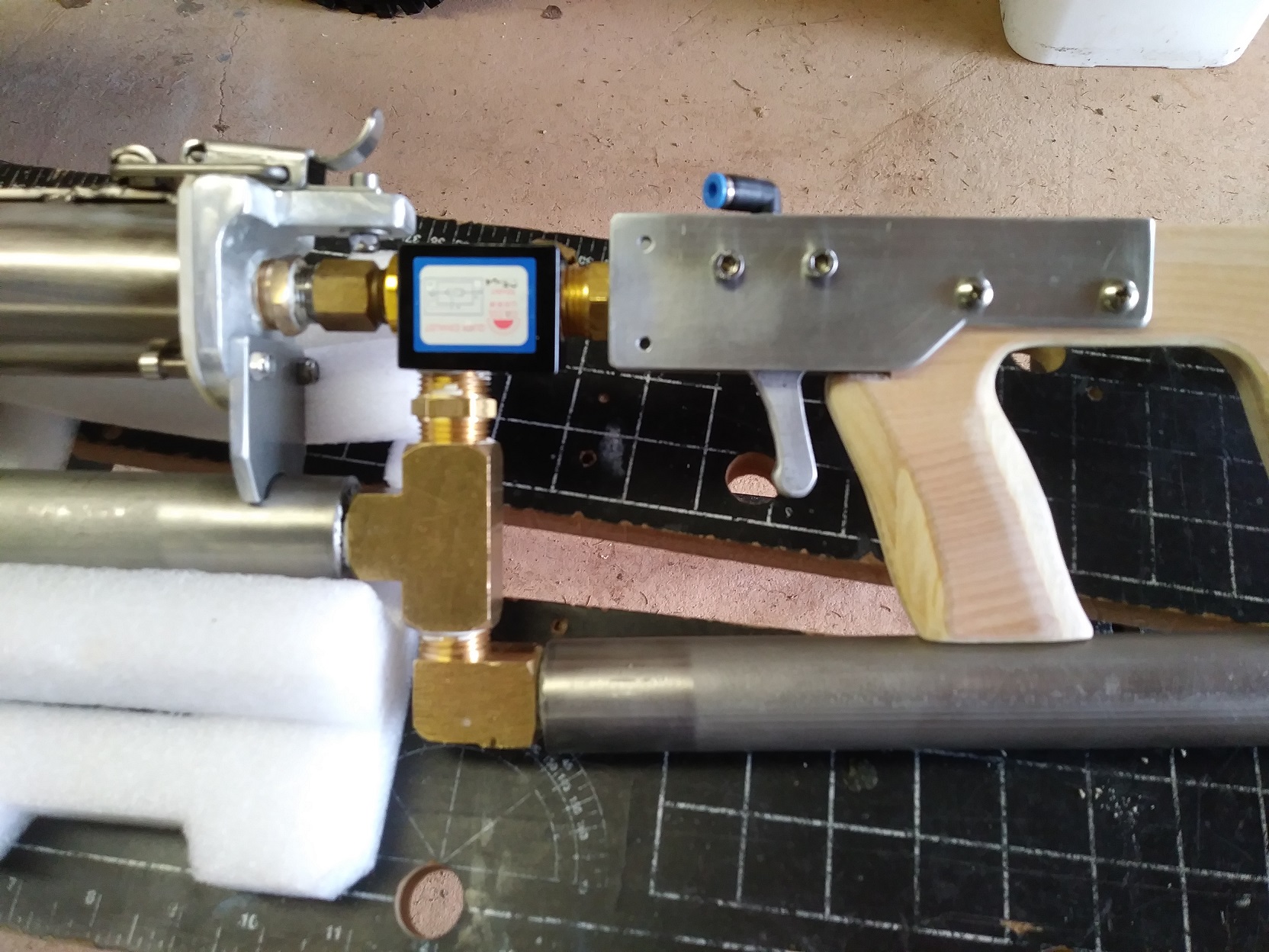

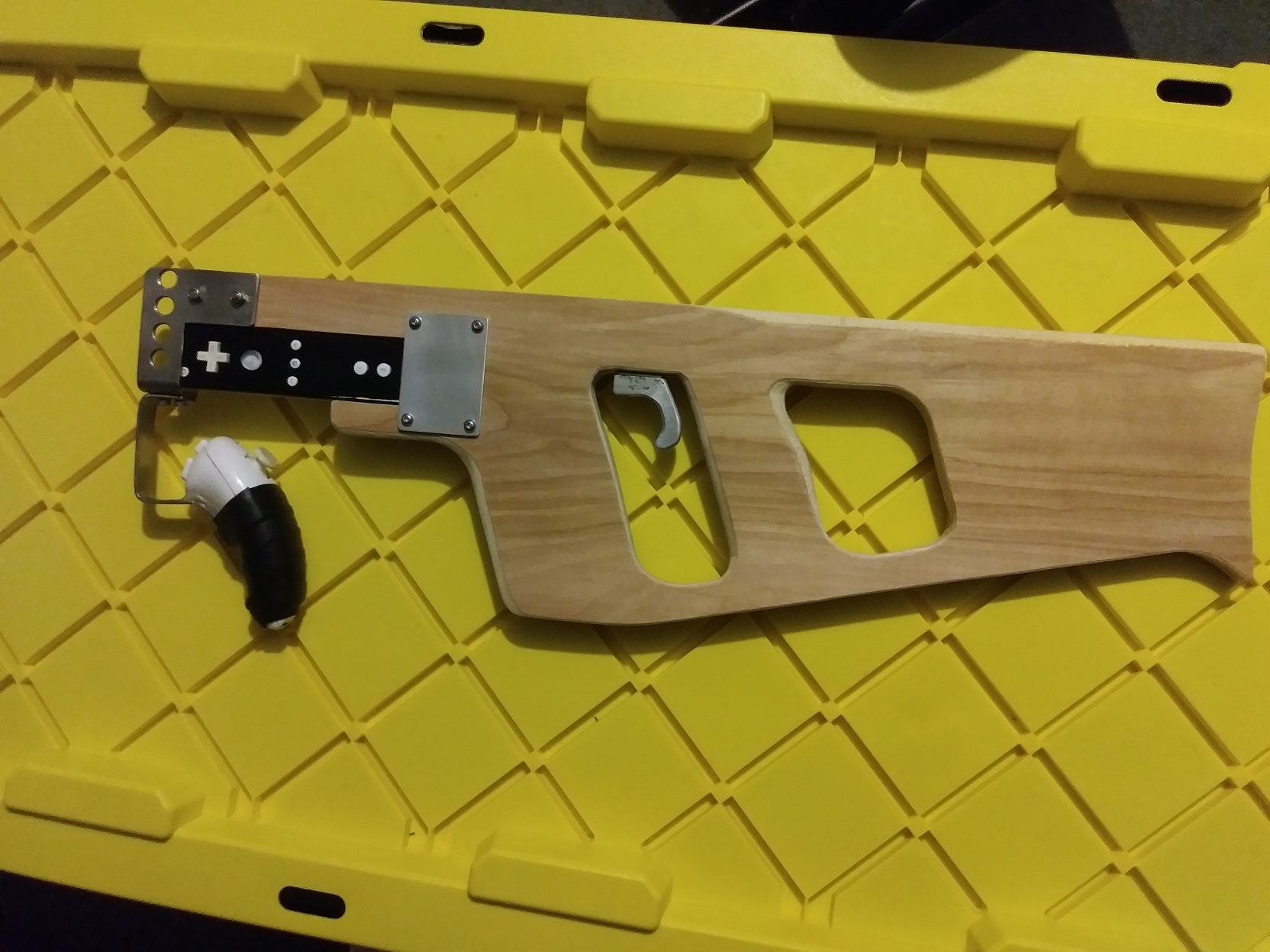

First fitting of the stock, it is actually the MkI Wii light gun stock that I kept just in case, fits perfectly, just need to reshape the top aluminium brackets.
MkII Wii gun

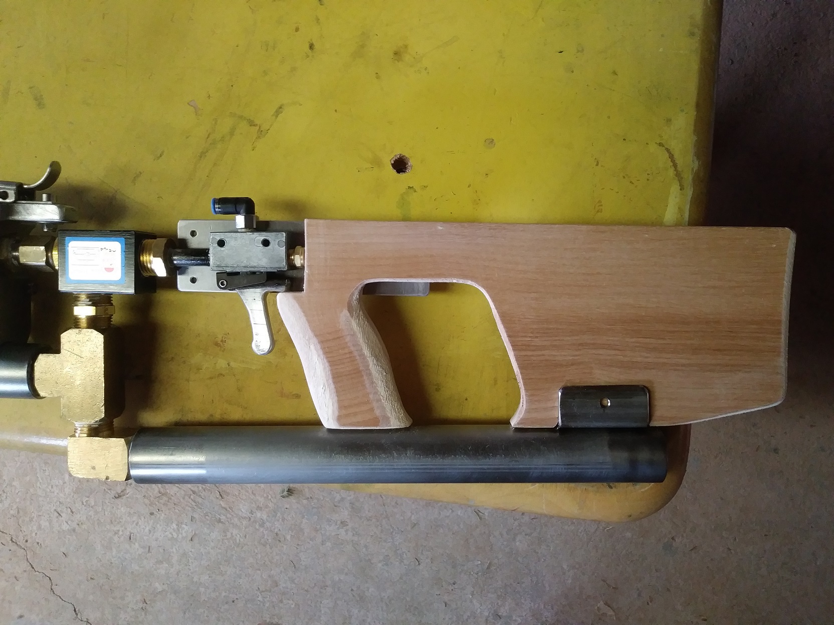

Sun Apr 21, 2019 11:28 am
Stock fitted, going to make some side plates to cover the QEV.
Dry fire at 150psi, a good puff of vapor? fired a dimpled foam golf ball, went over the house, probably 200 feet.

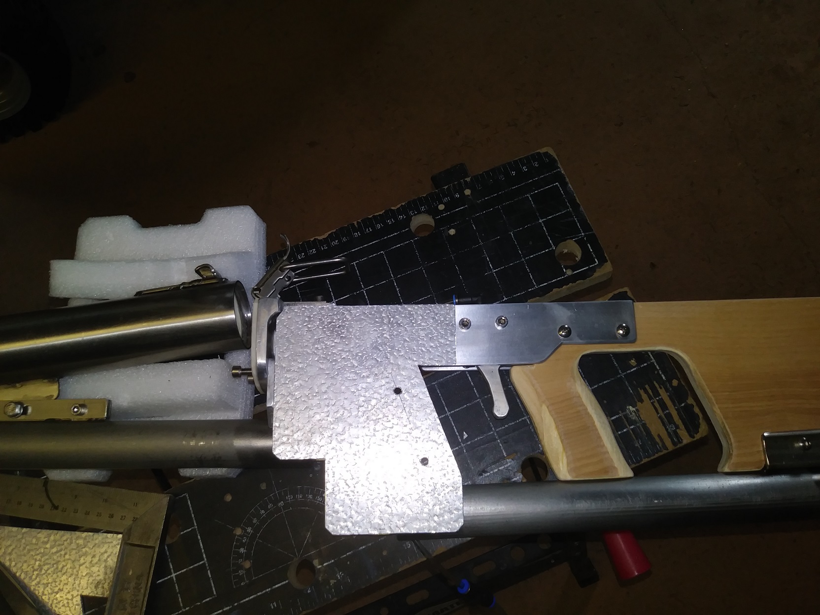

Sat Apr 27, 2019 3:05 pm
First fitting of side plate

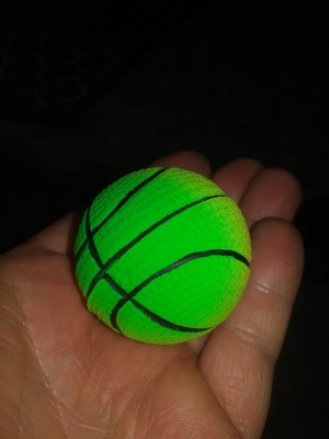

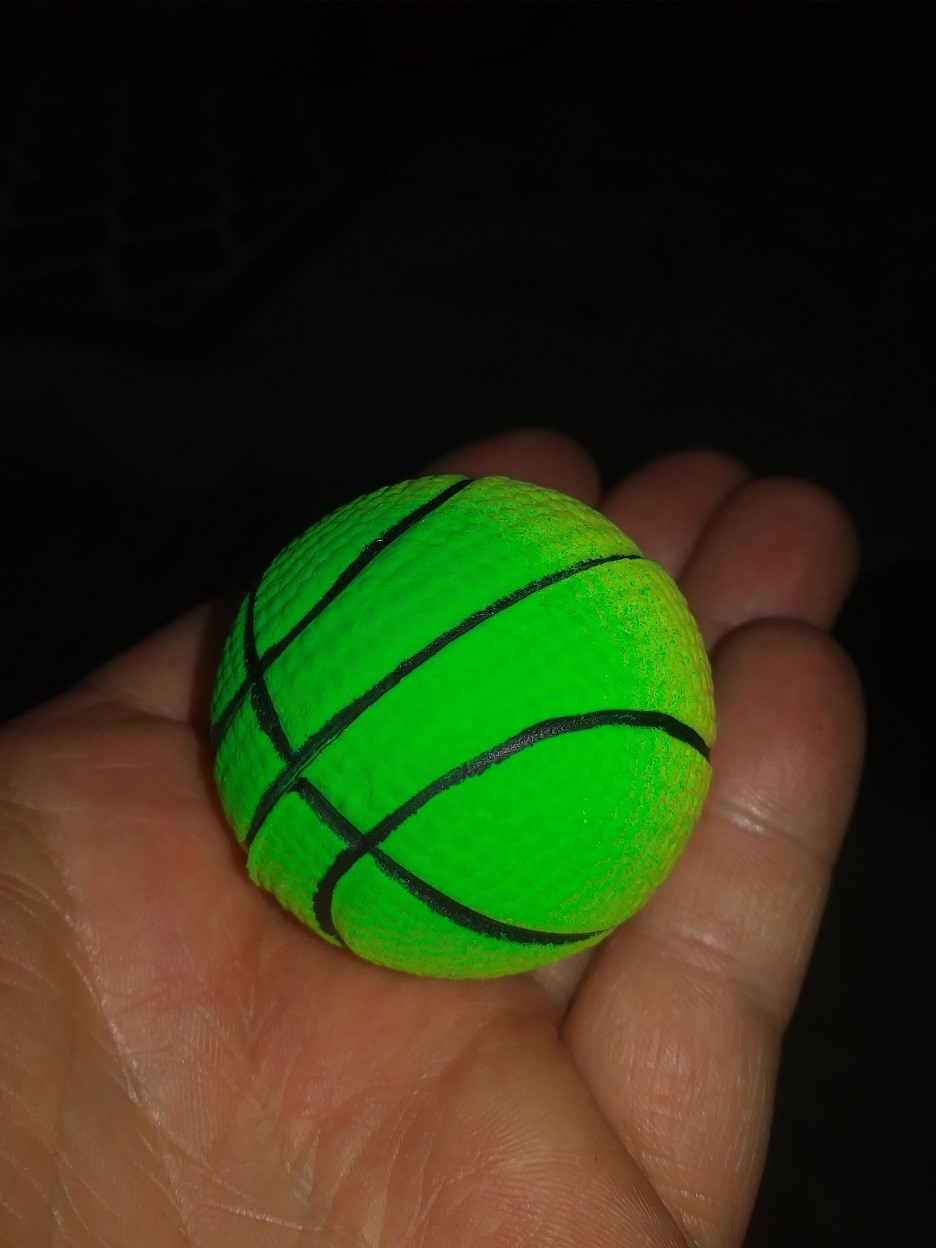

A new ammo to try, hard rubber bouncy ball, $0.50 form the local Dollar store :o Same size as the practice golf balls.
These dimpled ones will go 200'
