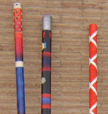

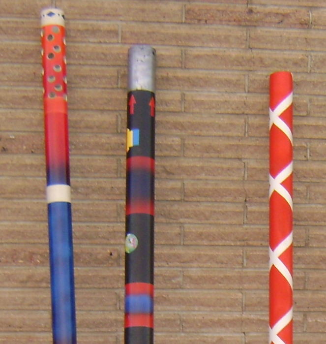

I love screw on barrels. The ammo variety increase is fantastic.gabeb123 wrote:next im going to modify the sprinkler valve and im going to make a new bigger barrel for it im thinking 2" because i have tons of empty caulk tubs laying around.
- Willdebeers
- Specialist 2
- Posts: 214
- Joined: Tue Feb 03, 2009 1:18 pm
Nice paint job!Technician1002 wrote:I love screw on barrels. The ammo variety increase is fantastic.gabeb123 wrote:next im going to modify the sprinkler valve and im going to make a new bigger barrel for it im thinking 2" because i have tons of empty caulk tubs laying around.
- Willdebeers
- Specialist 2
- Posts: 214
Nice. But what's the point of having threads when you only have one barrel?
