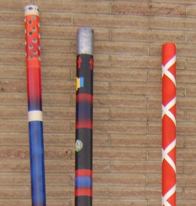

next im going to modify the sprinkler valve and im going to make a new bigger barrel for it im thinking 2" because i have tons of empty caulk tubs laying around.
gabeb123 wrote:next im going to modify the sprinkler valve and im going to make a new bigger barrel for it im thinking 2" because i have tons of empty caulk tubs laying around.
I love screw on barrels. The ammo variety increase is fantastic.
Variety of barrels to choose from is good.
Nice paint job! :D You could always use a piston valve, as they are very powerful and open very quickly. *Cough Destroyer MKII Cough*

If you do make several screw on barrels, remember to use female threaded adapters. Not many people seem to do this, but those who do realize that it is an extremely easy way to breech load. :wink:
gabeb123
Posts: 47
Joined: Sat Mar 14, 2009 5:23 pm
its allready set up for screw on barrels i just only have one barrel the female threads are on the barrel
