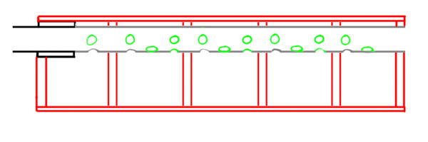

What I had in mind initially was crudely this:
Black is barrel, grey is an extension of it and red is the main structure of the suppressor.
The ports marked in green would be the ones covered by reed valves - allowing flow into the cavity, but not out. Only the rear most port in each cavity would be uncovered (or perhaps partially covered).
This doesn't seal off the air in the barrel or chamber, of course*, but it is still dramatically reducing the rate at which a large portion of the gas volume can rapidly vent to atmosphere.
*That said, the jets of air from the rear ports will provide some degree of slowing turbulence.

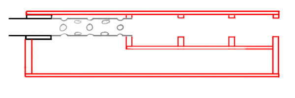

Here's the solution I had found for larger bores:
Not shown in the diagram are the ports in the chamber closest to the muzzle connecting the grey inner tube to the black outer tube. This gives you the possibility of creating a series of effective baffles within a relatively small diameter tube coupled with an unobstructed line of sight, while still giving you a large volume for pressure to drop via expansion (and heat loss of course ;) )

jackssmirkingrevenge wrote:Here's the solution I had found for larger bores
I do like that hybrid approach to the problem. Perhaps modified slightly, to capitalise on the potential gains of muzzle venting:
(Probably with more numerous and sophisticated baffles than that, but I just hacked apart the picture I did earlier).
I guess it is possible to omit any extension of the barrel if needs be, but the muzzle fitting as I've built/designed it at the moment will align and support weight better if used that way.
I don't know whether I'd try incorporating reed valves into this design though.
