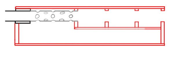

Here's the solution I had found for larger bores:
Not shown in the diagram are the ports in the chamber closest to the muzzle connecting the grey inner tube to the black outer tube. This gives you the possibility of creating a series of effective baffles within a relatively small diameter tube coupled with an unobstructed line of sight, while still giving you a large volume for pressure to drop via expansion (and heat loss of course ;) )

jackssmirkingrevenge wrote:Here's the solution I had found for larger bores
I do like that hybrid approach to the problem. Perhaps modified slightly, to capitalise on the potential gains of muzzle venting:
(Probably with more numerous and sophisticated baffles than that, but I just hacked apart the picture I did earlier).
I guess it is possible to omit any extension of the barrel if needs be, but the muzzle fitting as I've built/designed it at the moment will align and support weight better if used that way.
I don't know whether I'd try incorporating reed valves into this design though.

Ragnarok wrote:I guess it is possible to omit any extension of the barrel if needs be, but the muzzle fitting as I've built/designed it at the moment will align and support weight better if used that way.
For a smoothbore, go with a full length perforated barrel extending to the tip of the suppressor. It's the only way to guarantee prevention of baffle strikes with unrotated projectiles - as used on shotgun suppressors:

jackssmirkingrevenge wrote:For a smoothbore, go with a full length perforated barrel extending to the tip of the suppressor.
The downside is that's obviously going to affect gas and sound diffraction, and will thus reduce the effectiveness of the baffles. Well spaced ports can be made pretty large and high flow, but it's never going to be flawless.
Hmm. Maybe there could be something in angled ports.
