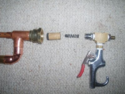

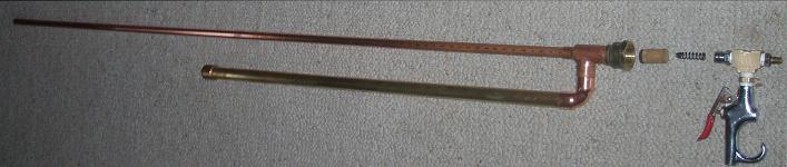

Well this is my first ever full copper and brass Musket.I haven't been able to shoot it yet,because I need one more fitting!Which will probably be longer then a week away due to me being Broke.Anyways here is the run down.
~specs~
70cmx20mm Brass Chamber
77cmx15mm Copper Barrel
Piston Housed In 20mm Tee
Schrader Filling Valve
BlowGun Pilot Valve
10 - 300psi running pressure
365fps @ 150psi with 7gram sinker

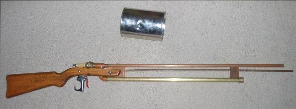

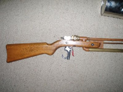

This is the Copper Musket Mk II,with it's new set up and I'm very proud to be the owner and builder of it and it is great to shoot.The pictures say it all,read above for the specs.
There are a few things I have added to it's original design,like a Stock and barrel supports which have holes bored in them allowing for the ram rod which is made of brass to sit below the barrel.It is pretty accurate and not as loud as I thought it would be with shortened barrel,but a suppressor might be on the way.

- The before gun.
- cope5#.jpg (29 KiB) Viewed 7925 times

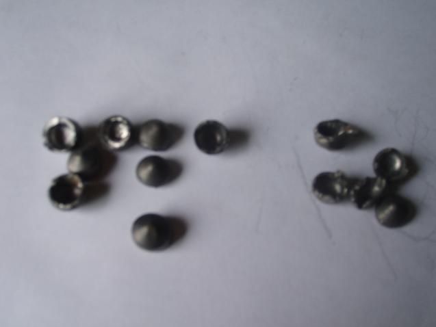

- The Ammunition
- base1#.jpg (21.9 KiB) Viewed 7695 times
- The whole musket,with ram rod and that is a coffee can that was filled with water and it shot through it easily.
- P1010045.jpg (32.22 KiB) Viewed 7540 times

looking good, what did you use as a piston?
Duly noted, but do you need the spring?Note I tried to keep the pilot volume small as possible.

I used a piece of dowel which I picked up out of my shed and it was a perfect fit first time.Some Neoprene for the sealing face and a small screw.

Looks good so far Duelers, you made very good use of that Brass that you found. Is that piston a cork? I think you may have problems with it jamming due to the compression of 160psi, i may be wrong though, good luck with the build
Edit: Dowel it is, sorry, i kind of drew a conclusion that you+bottle of wine....

He just told you it's a dowel ;pNovacastrian wrote:Is that piston a cork
A synthetic one, probably, though the jamming issues Novacastrian mentioned could be an issue.Carlman wrote:A cork would work also wouldnt it?

Like I said above, a cork could compress leading to jamming possibilities, well thats my theory anyway!Carlman wrote:looks like a cork and a bit of rubber...INGENIOUS!!

I guess it would but not at high pressures,it would blow out easily.Haha at me again just because I love my antioxidants in liquid form I see

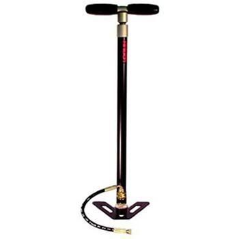

What do you guys think of a stirrup pump?Used for a Air Rifle,adopted for an Air Musket.Musket such a good word
I would love 300psi shots trust me.

That looks like the shiznit- how much are they going to bung you for that?
- rna_duelers
- Staff Sergeant 3
- Posts: 1739
- Location: G-land Australia
Around 80 pounds,so it's not cheap.But I'll do some searching and see what I can find around the place,hopefully one cheaper then that.They are capable of 230bar pressure though,so you get what you pay for.
