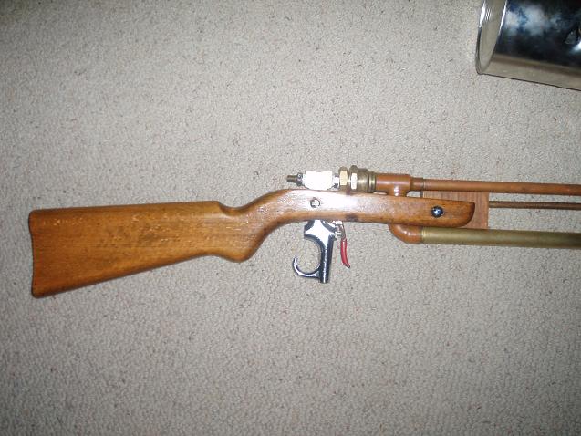

This is the Copper Musket Mk II,with it's new set up and I'm very proud to be the owner and builder of it and it is great to shoot.The pictures say it all,read above for the specs.
There are a few things I have added to it's original design,like a Stock and barrel supports which have holes bored in them allowing for the ram rod which is made of brass to sit below the barrel.It is pretty accurate and not as loud as I thought it would be with shortened barrel,but a suppressor might be on the way.

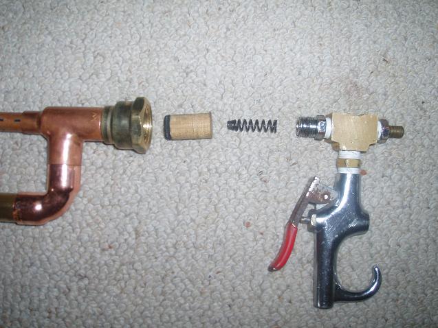

- The before gun.
- cope5#.jpg (29 KiB) Viewed 9097 times

- The whole musket,with ram rod and that is a coffee can that was filled with water and it shot through it easily.
- P1010045.jpg (32.22 KiB) Viewed 8712 times

looking good, what did you use as a piston?
Duly noted, but do you need the spring?Note I tried to keep the pilot volume small as possible.

I used a piece of dowel which I picked up out of my shed and it was a perfect fit first time.Some Neoprene for the sealing face and a small screw.

Looks good so far Duelers, you made very good use of that Brass that you found. Is that piston a cork? I think you may have problems with it jamming due to the compression of 160psi, i may be wrong though, good luck with the build
Edit: Dowel it is, sorry, i kind of drew a conclusion that you+bottle of wine....
He just told you it's a dowel ;pNovacastrian wrote:Is that piston a cork
A synthetic one, probably, though the jamming issues Novacastrian mentioned could be an issue.Carlman wrote:A cork would work also wouldnt it?
HAHAHAHA!Edit: Dowel it is, sorry, i kind of drew a conclusion that you+bottle of wine....
Touché

Like I said above, a cork could compress leading to jamming possibilities, well thats my theory anyway!Carlman wrote:looks like a cork and a bit of rubber...INGENIOUS!!
EDIT: damn i really should reload tabs before posting...
Edit: Damn you Jack!!

I guess it would but not at high pressures,it would blow out easily.Haha at me again just because I love my antioxidants in liquid form I see
