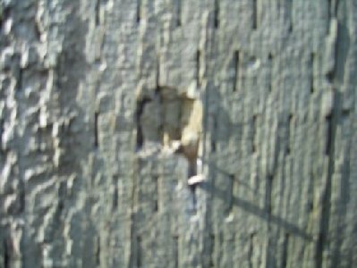

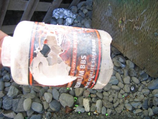

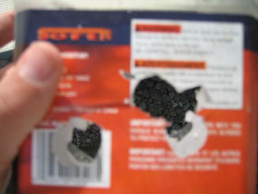

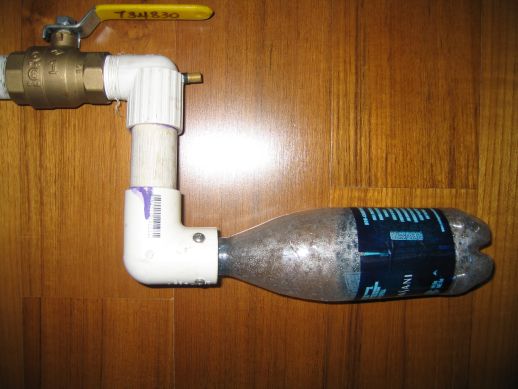

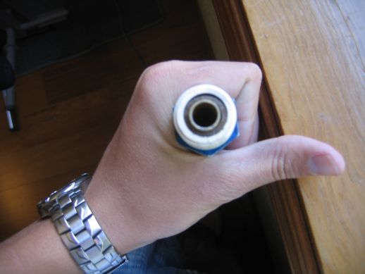

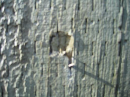

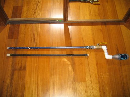

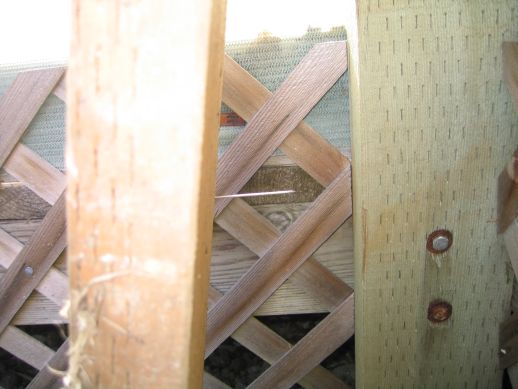

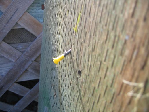

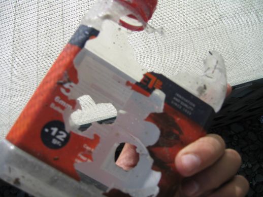

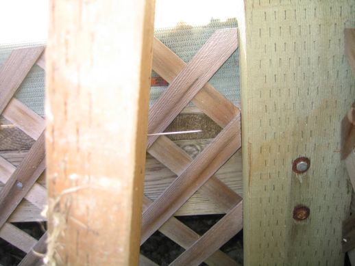

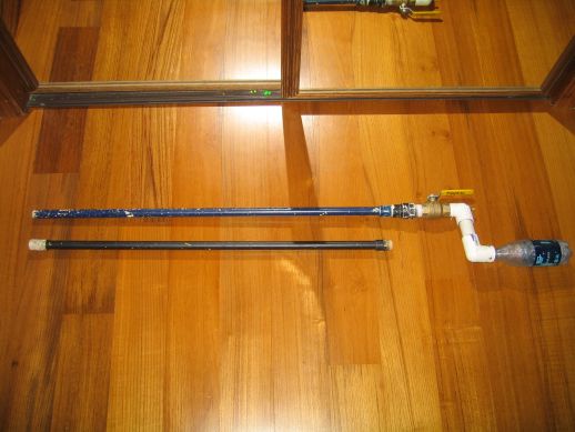

This is my mini pneaumatic it has a dasani botte for th chamber 1" fittings the botle is attache dyo the chamber by leaving the cap on putting a litle pvc glue around the cap screw it in to the female 1" threaded then put holes in the cap then pout scrws for saftey i have a 3/4" cpvc barrel and ones sleaved with a blowgun barrel in it it has a 1" ball valve and a bike tire valve bulled through with a hammer it doesnt leak at all and i take it up to 125 psi hope you like the damage picks the ones with the board were darts going through a 2" by 6" the others were done with non-frozen paintballs

sleaved lowgun barrel .40 Cal
Paintball damage
Paintball damage
pb damage
pb damage
pb damage
pb damage
pb damage
pb damage
dart through a 2 by 6
fat dart didnt quit make it i tihnk it hit at a weird angle

nece gun where did you get the barrel
beebs111
Posts: 807
Location: massachussets
Tue Apr 25, 2006 8:44 pm
probably off of one of those sporting websites: its a .40 cal blowgun barrell

Ummm I dont think water bottles are rated for the same pressure as soda bottles. Last year when we were making air powered bottle rockets my science teacher said to only use the soda bottles that hold a carbonated drink not to use anything that held something non-carbonated like lemonade, water, ice tea, ect. The non-carbonated ones probably are rated but to a lower pressure than the carbonated ones.
It will still work (obviously if you pump to 125) but I wouldnt pump it up past 80 psi, just because what if you drop it.

yah im careful about touching it to anything when its charged i take it up a 100 psi but there really easy to switch so if it bloes or starts to bulge ill change it and i got the blowgun form my grandpa lol

i just dont get why people use soda bottles for chambers, also atleast put a spring on that ball valve.
Rambo
Posts: 509
Wed Apr 26, 2006 1:11 am
The soda bottle is cheap easy to get and mount and it is very safe.

Yeah they are fine,cheap and strong i use them for all of my pneumatics nearly i've only ever had 1 blow out in 3 years and on about 4 cannons thatb have been shot over 500 times estimated.
