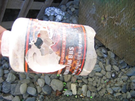

This is my mini pneaumatic it has a dasani botte for th chamber 1" fittings the botle is attache dyo the chamber by leaving the cap on putting a litle pvc glue around the cap screw it in to the female 1" threaded then put holes in the cap then pout scrws for saftey i have a 3/4" cpvc barrel and ones sleaved with a blowgun barrel in it it has a 1" ball valve and a bike tire valve bulled through with a hammer it doesnt leak at all and i take it up to 125 psi hope you like the damage picks the ones with the board were darts going through a 2" by 6" the others were done with non-frozen paintballs

Paintball damage
Paintball damage
pb damage
pb damage
pb damage
pb damage
pb damage
pb damage
dart through a 2 by 6
fat dart didnt quit make it i tihnk it hit at a weird angle
