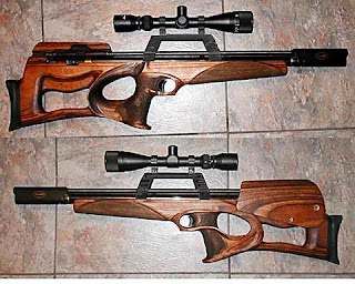

Here's some examples for inspiration:
chinnerz
Posts: 470
Sat Jan 02, 2010 2:35 am
thanks for that jack, they look quite complex

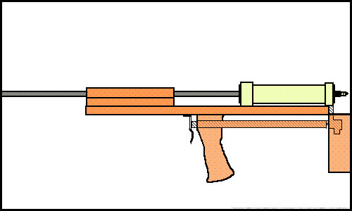

yeah... wow that like was my first plan.
but if you see you have a good 25 cm of wood with nothing sitting on top of it. which is why i decided to move the trigger 20 cm forward so i can save space.
10 second sketch
idea number 1 ^^
spudamine
Posts: 184
Joined: Sun Nov 23, 2008 2:47 pm
Sat Jan 02, 2010 4:25 am
I Like the way you've gone for more of a bullpup design, a lot of people don't like the look of a bullpup but when you're building a spudgun you can't afford to be picky when power is at stake and you can get a good bit extra out of those 20cm without compromising the comactness.
