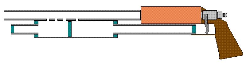

Integral suppressor disguised as magazine/pump added:
Suppressor internal configuration and planned trigger/pistol grip configuration:

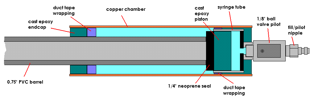

I've been wanting to build something like this ever since I got my first paintball tank. Nothing exceptional about the design, made with my usual epoxy endcap/piston construction as the internal diagram shows. Barrel is 18 inches of 0.75" PVC. The plan is to take it to 800 psi, so far I've only taken it to 500 psi. A quick chrony test showed a healthy 192 fps for a 30 gram empty CO<sub>2</sub> capsule, just under 38 ft/lbs of muzzle energy. Pretty damn loud too, I might be persuaded to fit it with a pistol grip and a suppresser styled like a shotgun pump.

diagram of the internals

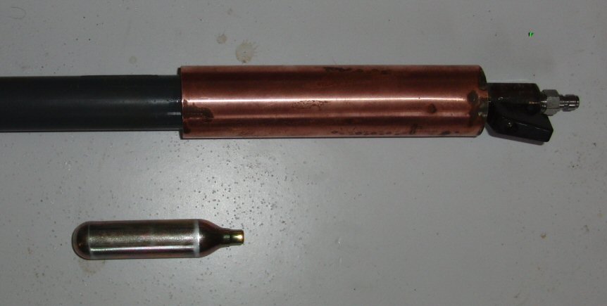

chamber closeup with a 12 gram capsule for size comparison

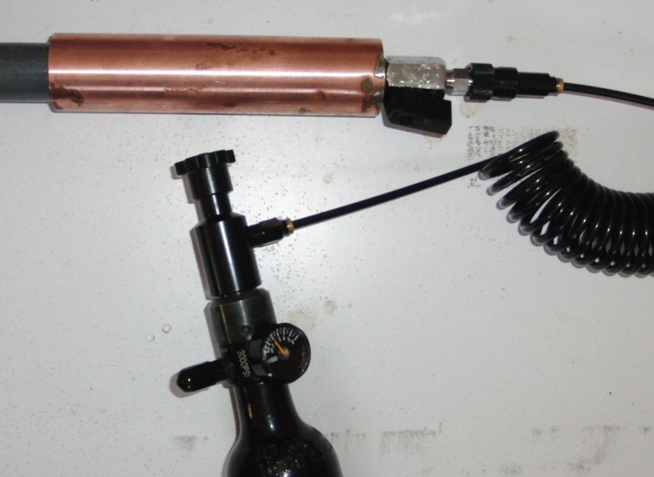

filling from a paintball bottle through a remote line

Here's how it might looks like if I bother with a pistol grip and suppressor:
Sat Jul 10, 2010 9:58 am
nice but it should be valveless and full auto :D

There seems to be hardly an chamber at all, it's no wonder you only got 40 fps at 100 psi :roll:

Gun Freak wrote:There seems to be hardly an chamber at all, it's no wonder you only got 40 fps at 100 psi :roll:
Total volume is about 0.5 cubic inches ;) C:B ratio of 1:16, you can afford it with HPA...

Alright, I guess the hpa makes up for it, but in that diagram you posted with the grip, is that a chamber extension under it?
