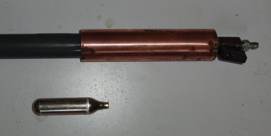

Fed up of playing with countless 1mm BBMG prototypes, I figured I'd take a break and play with something a little bigger :D
I've been wanting to build something like this ever since I got my first paintball tank. Nothing exceptional about the design, made with my usual epoxy endcap/piston construction as the internal diagram shows. Barrel is 18 inches of 0.75" PVC. The plan is to take it to 800 psi, so far I've only taken it to 500 psi. A quick chrony test showed a healthy 192 fps for a 30 gram empty CO<sub>2</sub> capsule, just under 38 ft/lbs of muzzle energy. Pretty damn loud too, I might be persuaded to fit it with a pistol grip and a suppresser styled like a shotgun pump.

chamber closeup with a 12 gram capsule for size comparison

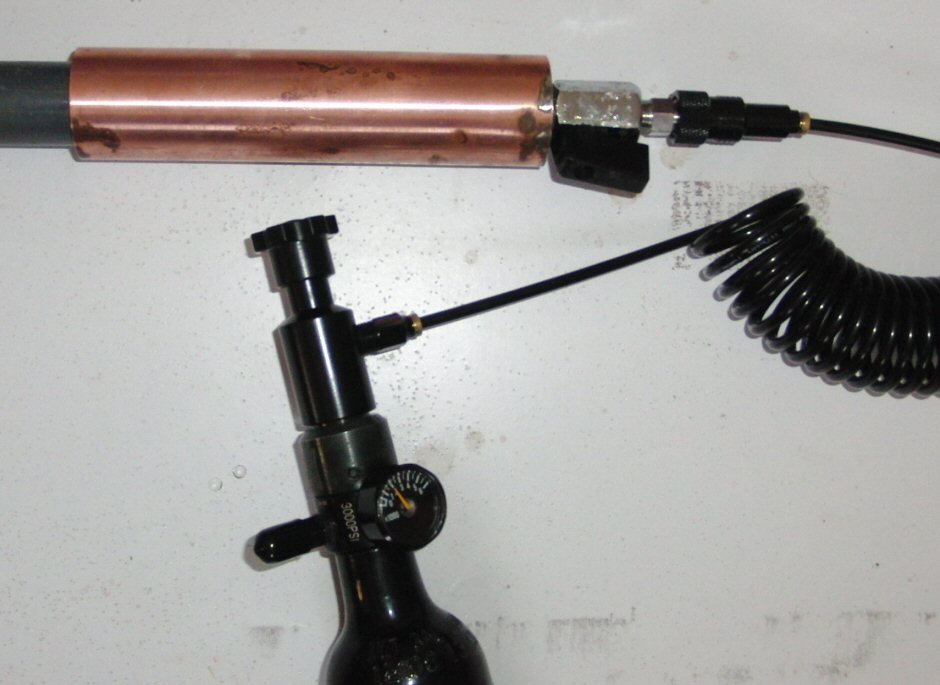

filling from a paintball bottle through a remote line

Total volume is about 0.5 cubic inches ;) C:B ratio of 1:16, you can afford it with HPA...
