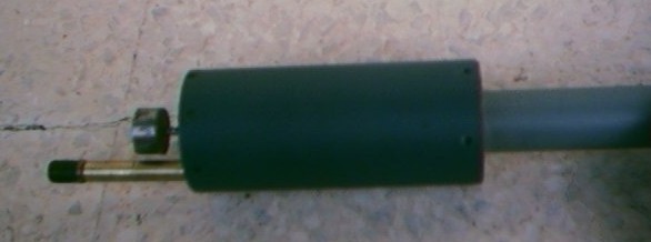

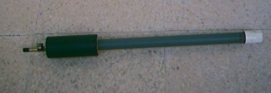

On the subject of suitable pilots vis a vis piston construction, here's one from the archives :)
My first "large bore" co-axial from 2004 which I made using the body of a foot pump as a chamber. Because of the fact that I used the pump head (with a floating o-ring) as the piston, I was able to pilot the (2" diameter!) piston with a schrader ;)

Note that schrader piloting was only possible because of the o-ring seal on the piston which effectively prevented air from the chamber leaking back into the pilot.

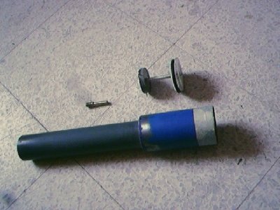

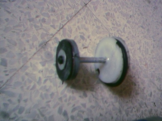

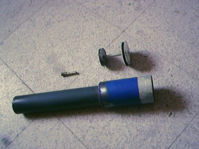

On a slightly unrelated note, while looking through my archives I found pictures of a "QDV" type launcher I had made, this was in 2003 :D
s3d version 2.0.jpg (19.95 KiB) Viewed 5810 times
s3d version 2.0 (1).jpg (19.88 KiB) Viewed 5810 times

Wow another vintage QDV. Did it have a sliding piston on a rod?
