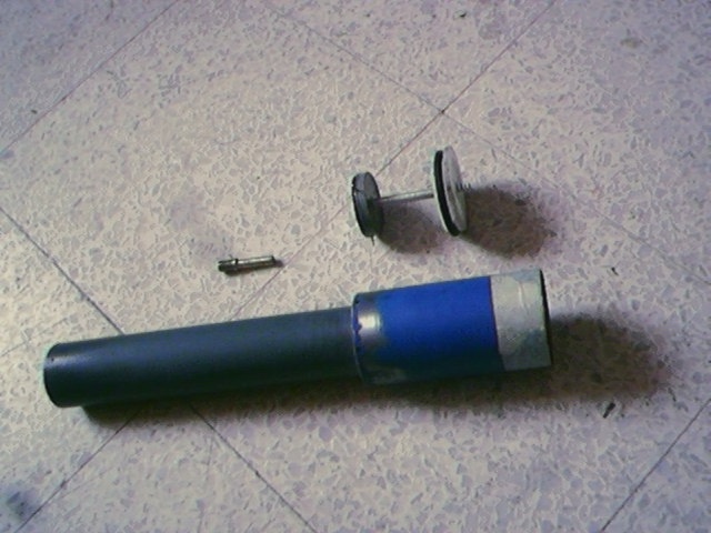

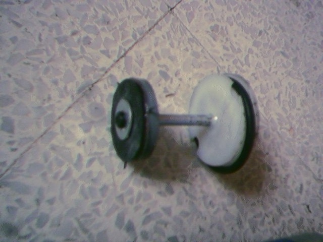

On a slightly unrelated note, while looking through my archives I found pictures of a "QDV" type launcher I had made, this was in 2003 :D
s3d version 2.0.jpg (19.95 KiB) Viewed 7065 times
s3d version 2.0 (1).jpg (19.88 KiB) Viewed 7065 times
LOL LOL LOL

Wow another vintage QDV. Did it have a sliding piston on a rod?
That would have been made shortly after the Cell Core test cannon, AKA my apple cannon.
I need to dig through 35mm negatives and see if I can find the date I made my first QDV. It was before I got my first digital camera. I have some prints of it shooting adding machine tape at summer camp -- somewhere.
:roll: I have no idea where the negatives are now. The receipt date for the processing would be a good find.
