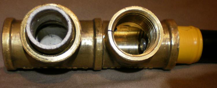

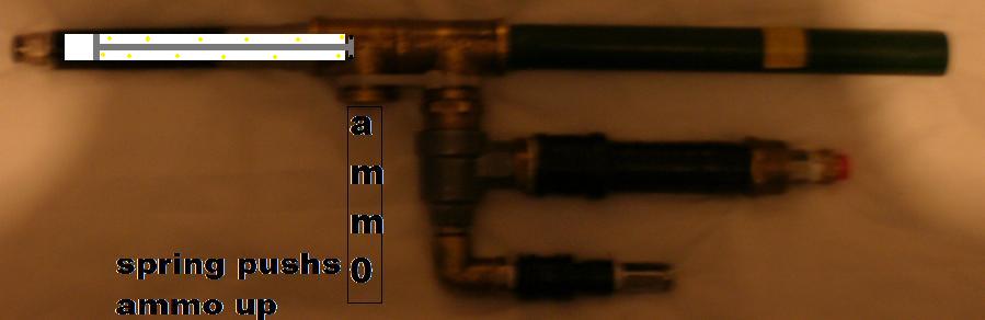

Reload mech: homemade air cylinder to cycle ammo, the receiver is two brass tees with a peace of 20mm copper pipe soldered in it.
thanks to Poland_spud and jsr.
this is a old pic, of the receiver. it looks the same but i re-made the pvc parts in copper and solderd them in.

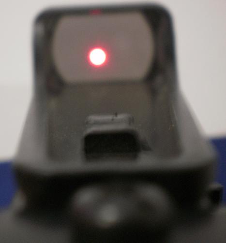

the red dot sight, i cant get a good pic. its on the macro setting

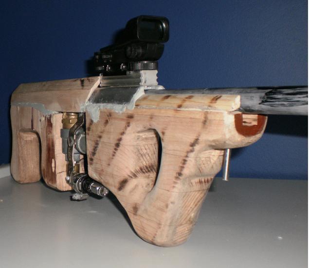

you can see the groove cut in the wood for the trigger to ride in.

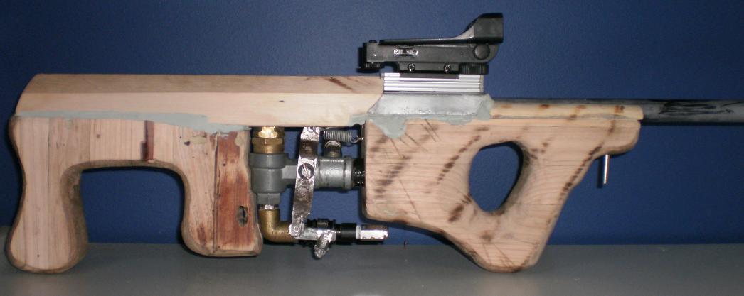

that is the hole thing. needs some finishing touchs. I have two aluminum plates that cover the valve and trigger rod.

The stock seems quite chunky, but very nicely done anyway. I think a caliber of that size at the pressure you intend to operate could do some serious damage. :D Post a video?

the red dot sight
It's one of those cheapo chinease reddots, right ?
I've always wondered if they're any good?

So air ram connected to chamber loads ammo from behind the QEV ?
Does the trigger close the fill valve and pilot in one action ?

I have a cheap red dot, the main issue, is the dot will wander slightly if you move your head. If there is a stock on the gun and the cheek rest is used it is OK.
Thu Apr 21, 2011 3:43 pm
I don't think that's surprising... they are to behave in that way.... the only question is how well does this feature work
al-xg
Great Britain
Posts: 643
Thu Apr 21, 2011 4:19 pm
A good red dot sight should stay on target even if your head moves, cheap ones drift. So unless you resume the exact same position when looking through the sight, the point of aim will be slightly different.
I tried a $600 EOtech and I definitely didn't drift like my cheapo one does.

Alster370 wrote:The stock seems quite chunky, but very nicely done anyway. I think a caliber of that size at the pressure you intend to operate could do some serious damage. :D Post a video?
the stock is only 45mm thick, i cbfed sanding it more round and its stronger this way. ill get a damage pics soon and if i can find something to protect my video camera ill have videos

the red dot sight
yea, i only got it for look it was only 68 cent and free delivery. the rail i made at work (on the mill wooot) they dont let me use it much :(
al-xg wrote:So air ram connected to chamber loads ammo from behind the QEV ?
Looks good !
yea that how it works, the trigger pilots in when you pull back and fills when you let go, i have a safety that stops it coming back if you engage it.

im going to paint the top 1/3 black to cover all the epoxy putty and walnut stain the rest. then if it looks stupid mate black everything. ill lever the alu riser and rails alone

If I could make a small aesthetic/safety suggestion, it needs a trigger guard.

A diagram of the feed mechanism would also be of interest if you have the time ;)

jackssmirkingrevenge wrote:
Crna Legija wrote:expect vids/new pics soon.
Looking forward to them :)
What's performance like? I've found marbles that fit very well in 20mm conduit (17mm) so maybe some searching is in order to reduce blowby and optimise velocity.
defiantly need a new barrel, im looking. i might be getting 500 15mm ss bbs for free, if so i have a steel barrel id is 15.07mm i would just need to get 1/2'' bsp threads on one end, but i can do that at work.
but the power is pretty good for the barrel, easily puts marbles though 9mm mdf boards.
i made a safety that when you push it in the trigger cant be pushed back, and the trigger is really stiff so i don't think it needs a real guard
you should be able to figure the rest out
