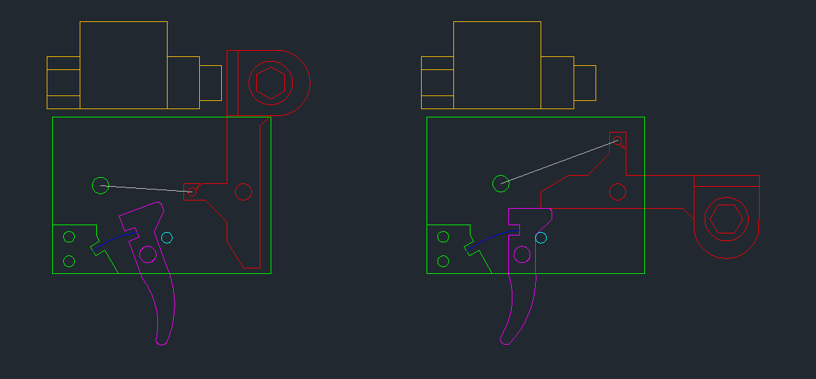

Its a good idea, but still complex.
I've made things a lot more simple with this rotating hammer:

What are you using for your valve.
That is all.

McMaster push button valve. LnL says it is easy to open, so my hammer doesn't have to be ridiculously solid or big.clemsonguy1125 wrote:What are you using for your valve.

It's not a totally balanced valve, but I can open it with my finger at 700psiGun Freak wrote:McMaster push button valve. LnL says it is easy to open, so my hammer doesn't have to be ridiculously solid or big.clemsonguy1125 wrote:What are you using for your valve.

I'm not expecting it to be balanced. But if you can open it at 700 with your finger (how hard is it 1-10?) then my wimpy hammer can open it at 260.

So that's like lifting a 2 lb weight with your finger? Ok not bad. So less than a pound at 260. LnL, have you measured the seat diameter yet?

It's not leverage that's my advantage, its momentum. But yeah I think the hammer will be fine. I can always increase the mass of it by adding a couple washers.
