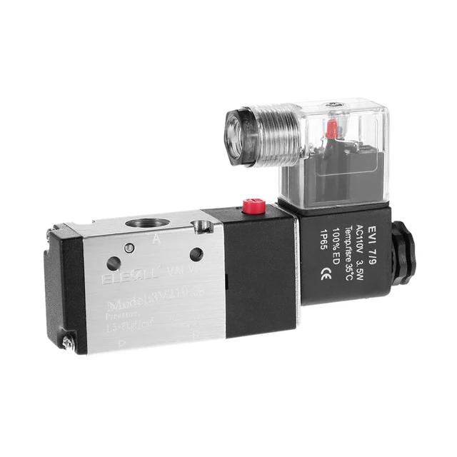

Sat Sep 01, 2018 9:06 am
If I'm not mistaken a lot of 3 way control valves are already internally pneumatically actuated. Mostly the ones with very easy to actuate switches or solenoids, if you buy one with 1/4" or larger ports you probably have a perfectly adequate opening speed for a small airsoft or Nerf gun build. I bought one a while back for $15 for a Nerf project I never finished.
It was kinda like this
Image I had to switch the solinoid to the other side to make it a "normally open" configuration but it had plenty of power for my needs

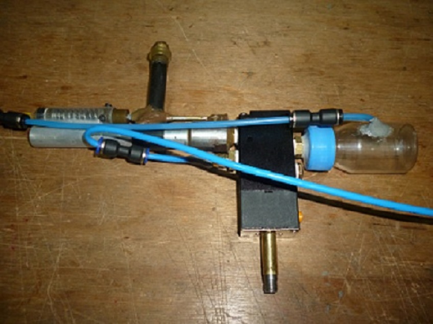

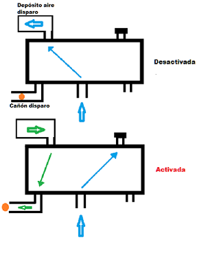

Argentina
Posts: 1064
Location: Argentina
Has thanked: 274 times
Been thanked: 276 times
Sat Sep 01, 2018 12:50 pm
I have a weapon for BB plastic 6mm with a 5/2 operated as a 3/2, it uses a little pressure about 60 psi, it is semiautomatic. I leave here a picture.
